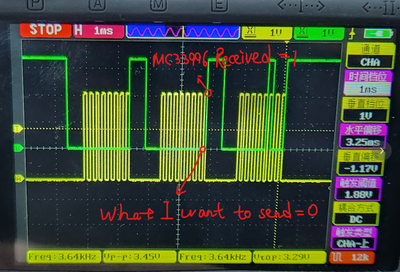

I encountered a problem, when I use SPI communication mode to control the LSD output pin of the development board, no matter what message I send to the LSD chip, there will be two LSD pins continuously output (connected to GND), for example, I send three consecutive 8-byte messages (three frames are uint 0), theoretically all LSD pins should not output. However, the measurement found that the above two pins are still output state.
I replaced two boards of the same size. It's the same thing. Does anyone understand why?

The cause of this problem was found to be SPI sequence mismatch. The MC33996 LDS chip uses the second edge of the clock trigger to recognize the data sent by the MOSI pin, however, I chose the first edge when configuring the SPI configuration model, which means that the master sends data according to the first edge of the clock trigger.
I observed the signal with an oscilloscope, and the MOSI signal went up at the same time as the second side, so the MC33996 recognized a data "1" (which should be a useless data) when the signal went up, and it controlled the corresponding pin output.
The uncontrolled pin just matches the rising edge at the end of the first byte and the second byte. In other words, the MC33996 is receiving different control data than I want to send, which is why I can't control the PWM output.
