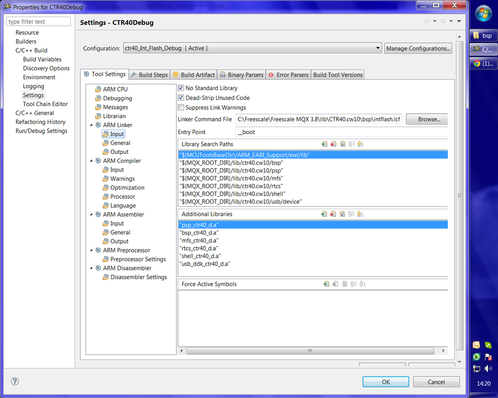

During compling i suddenly got this error. and i don't know how to remove it?
please help understand and solve it.

Teckna
Contributor V
Which compiler are you using?
In CW the path is C/C++ bulid/settings/ARM Linker/Input/Entry Point
Are you using MQX?
Label __boot is used in PSP!!

Swapnil_Enable
i am using CW 10.3 with MQX 3.8.1
i checked the same location u referred " C/C++ bulid/settings/ARM Linker/Input/Entry Point ".
if i create any new project it also have the same problem.

Teckna
Contributor V
In my project with CW10.3, MQX 3.8.1 and Entry Point as "__boot" it works!
I create also a new project and it works!
I attach screenshot of my linker options

Swapnil_Enable
Thanks all of you. i added Additional libraries in properties as seen in screen shot and the error  are gone... now what exactly was the problem still unknown...

Teckna
Contributor V
in project properties you must define entry point as __boot
