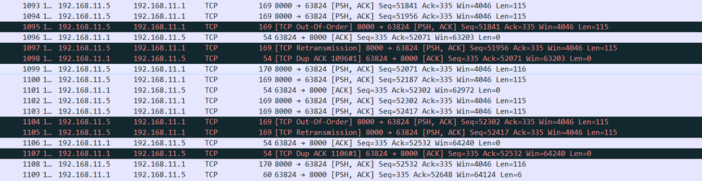

emanueletrapani
for a better explanation of the problem i need to precise that:
- the much of communication is from the MCU towards pc application.
- the retransmission is often preceded from a out-of-order packet.
this is the screenshot of a casual page on a wireshark while the communication is on.
do you think that the problem is the same in this case too?

Carlos_Musich
192.168.11.5 is MCU and 192.168.11.1 is PC?
7,652件の閲覧回数
emanueletrapani
yes, right!
it happens in the case my pc is not the gateway too.

Carlos_Musich
Hi Emanuele,
sorry for the delay.
- It is true that he MCU (192.168.11.202) is slower and cannot process all packets that PC (192.168.11.1) sends and it needs to ask for retransmission. However it is not that slow to loose all the packets shown in the capture you sent.
Please review the priority of your tasks. Which is the highest priority (lower number) you set? Note that all your tasks must have a lower priority (higher number) than the tcp/ip task. If there is another task with higher priority the tcp/ip task would be blocked and unable to process the TCP packets.
Carlos

                    if(err!=RTCS_OK){
                        fprintf(debug_uart, "\n\rtrasparent_8000: rtcs shutdown %d err: 0x%X\n\r",i,err);
                        //manage
                    RTCS_FD_CLR(TCP2SERsockets[i],&sock_set);
                    TCP2SERsockets[i]=0;
                    if (i!=0) {
                        if (_task_abort(ctrl_tid[i])==MQX_OK) {
                            PRINTF_DEBUG_TCP2SER (debug_uart,"\n\rtrasparent_8000 trasp, rtcs_err aborting ctrl task %d", i);
            _time_delay(200);
            start_server_sock();
            RTCS_FD_ZERO(&sock_set);
            RTCS_FD_SET(TCP2SERservsock,&sock_set);
        else if(err==0){//timeout
            PRINTF_DEBUG_TCP2SER (debug_uart,"\n\rtrasparent_8000 RTCS timeout 8000:");
        else{//activity
            if(RTCS_FD_ISSET(TCP2SERservsock, &sock_set)){//if(err==TCP2SERservsock){//new connection request
                //fprintf(stderr,"\n\rtrasparent_8000  Server activity\n\r");
                sockaddr_len=sizeof(TCP2SERVtempaddress);
                TCP2SERVtempsock=accept(TCP2SERservsock, &TCP2SERVtempaddress, &sockaddr_len);
                if(TCP2SERVtempsock==RTCS_SOCKET_ERROR){
                    fprintf(stderr,"\n\rtrasparent_8000  Server error\n\r");
                    retval = RTCS_geterror(TCP2SERservsock);
                    if (retval == RTCS_OK) {
                        printf("\n\rtrasparent_8000 Connection reset by peer");
                    } else {
                        printf("\n\rtrasparent_8000 Error, accept() failed with error code %x",retval);
                else{
                    for(i=1;i<=TCP2SERIAL_MAX_CLIENT_CONNECTIONS;i++){
                        if(TCP2SERsockets[i]==0){
                            break;
                    if(i>TCP2SERIAL_MAX_CLIENT_CONNECTIONS){//no connections available
                        //refuse connection
                        chiudisocket(TCP2SERVtempsock,0);//shutdown(TCP2SERVtempsock,FLAG_CLOSE_TX);
                        TCP2SERVtempsock=0;
                        fprintf(stderr,"\n\rtrasparent_8000  Connection refused\n\r");
                    else{
                        //Connection is maintained and handle saved
                        t=TRUE;
                        setsockopt(TCP2SERVtempsock,SOL_TCP,OPT_RECEIVE_NOWAIT,&t,1);
                        TCP2SERsockets[i]=TCP2SERVtempsock;
                        TCP2SERaddresses[i]=TCP2SERVtempaddress;
                        TCP2SERVtempsock=0;
                        fprintf(stderr,"\n\rtrasparent_8000 : Accepted connection by %08X, port %d\n\r",TCP2SERaddresses[i].sin_addr.s_addr,TCP2SERaddresses[i].sin_port);
                        task_p.i = i;
                        task_p.sock = TCP2SERsockets[i];
                        ctrl_tid[i]=_task_create(0,TCP2SER_CTRL_TASK_ID, &task_p);
                        if (ctrl_tid == MQX_NULL_TASK_ID){
                            fprintf(stderr, "\n\rtrasparent_8000 Impossible to start ctrl task");
        _time_delay(1);
void rx_task (uint32_t param)
    unsigned char i;
    int32_t ret;
    int32_t len;
    unsigned char tx_buf[(SER2TCP_BUF_SIZE/2)]={0};
    uint16_t tx_buf_index=0;
    PRINTF_DEBUG_TCP2SER (debug_uart,"\n\rtrasparent_8000 trasparent task on");
    _mqx_uint error;
    while(1){
        //_lwevent_wait_ticks(&SER2TCPbuf_events,0x02,TRUE,200);
            _mutex_lock(&SER2TCPbuf_mutex);
            tx_buf_index=0;
            while(SER2TCPbuf_bytes_avail>0){
                tx_buf[tx_buf_index++]=SER2TCPbuf[SER2TCPbuf_read_index++];
                SER2TCPbuf_bytes_avail--;
                if(SER2TCPbuf_read_index>=SER2TCP_BUF_SIZE){
                    SER2TCPbuf_read_index=0;
                if(tx_buf_index>=(SER2TCP_BUF_SIZE/2)){//64){
                    break;
            _mutex_unlock(&SER2TCPbuf_mutex);
            for(i=0;i<TCP2SERIAL_MAX_CLIENT_CONNECTIONS;i++){
                if(TCP2SERclientsocks(i)!=0){
                    ret=send(TCP2SERclientsocks(i),tx_buf,tx_buf_index,0);
                    if (tx_buf_index!=0) {
                        PRINTF_DEBUG_TCP2SER(debug_uart,"\n\rtcp2ser SENT:%d bytes to TCP", tx_buf_index);
                    if(ret==RTCS_ERROR){
                        ret=RTCS_geterror(TCP2SERclientsocks(i));
                        chiudisocket(TCP2SERclientsocks(i),0);
                        //if(ret==RTCSERR_SOCK_INVALID){
                            TCP2SERclientsocks(i)=0;
                        fprintf(stderr,"tcp2ser trasp tx, RTCS ERR: %x",ret);
        _time_delay(1);
uint32_t chiudisocket(uint32_t sock, uint32_t abort){
    struct linger l_options = {0};
    uint32_t ret=0;
    int32_t mode=0;
    int32_t err=0;
    //hard close
    mode=(int32_t)abort;
    // Set linger options for RST flag sending.
    l_options.l_onoff = mode;//1=abort, 0=graceful
    //l_options.l_linger_ms = 0;
    err=setsockopt(sock, SOL_SOCKET, SO_LINGER, (const void*)&l_options, sizeof(l_options));
    if (err == RTCS_OK) {
        err=closesocket(sock);
    ret=(uint32_t)err;
    return(ret);
void start_server_sock(void) {
    uint32_t errval;
    TCP2SERservsock=socket(PF_INET, SOCK_STREAM, 0);
    if (TCP2SERservsock == RTCS_SOCKET_ERROR){
        fputs("\n\rtrasparent_8000 Error: Unable to create socket for IPv4 connections.", stderr);
        //_task_block();
    PRINTF_DEBUG_TCP2SER (debug_uart,"\n\rtrasparent_8000 created srv sock 0x%X", TCP2SERservsock);
    ((sockaddr_in*) &TCP2SERservaddress)->sin_family = AF_INET;
    ((sockaddr_in*) &TCP2SERservaddress)->sin_port = TCP2SERIAL_SERVER_PORT;
    ((sockaddr_in*) &TCP2SERservaddress)->sin_addr.s_addr = INADDR_ANY;
    errval = bind(TCP2SERservsock, &TCP2SERservaddress, sizeof(TCP2SERservaddress));
    if(errval != RTCS_OK){
        //_task_block();
    errval = listen(TCP2SERservsock, 0);
    if (errval == RTCS_OK){
        fprintf(stderr,"\n\rtrasparent_8000 SERV listening on 8000\n\r");
    else{
        //_task_block();
void ctrl_activity_task (uint32_t param) {
    uint32_t sockets_array[2] = {0};
    uint32_t err = 0;
    unsigned char j = 0;
    rtcs_fd_set sock_ctrl_set;
    unsigned char tcp_rx_buf[TCP2SER_RX_BUF_SIZE];
    j = ((TASK_PARAMS_PTR)param)->i;
    sockets_array[0] = ((TASK_PARAMS_PTR)param)->sock;
    RTCS_FD_ZERO(&sock_ctrl_set);
    RTCS_FD_SET(sockets_array[0],&sock_ctrl_set);
    PRINTF_DEBUG_TCP2SER (debug_uart,"\n\rtrasparent_8000  start ctrl task for %d sock 0x%x ", j, sockets_array[0]);
    while(1){
        err=select(1,&sock_ctrl_set,NULL,NULL,TCP2SERIAL_RESET_SOCK_TIME);//err=RTCS_selectset(sockets_array, 1 , TCP2SERIAL_RESET_SOCK_TIME);
        if(err==RTCS_ERROR){
            //manage error
            err = RTCS_get_errno();
            PRINTF_DEBUG_TCP2SER (debug_uart,"\n\rtrasparent_8000 ctrl rtcs error is: 0x%x ", err);
            err=chiudisocket(sockets_array[0],0);
            if(err!=RTCS_OK){
                fprintf(debug_uart, "\n\rtrasparent_8000 ctrl: Shutdown %d err: 0x%X\n\r",j,err);
                //manage
            } else {
                PRINTF_DEBUG_TCP2SER (debug_uart, "\n\rtrasparent_8000 ctrl: Shutdown sock %d: 0x%X\n\r",j,err);
                TCP2SERsockets[j]=0;
            //End of operations - task kills itself
            _task_abort(_task_get_id());
            PRINTF_DEBUG_TCP2SER (debug_uart,"\n\rtrasparent_8000 ctrl RTCS timeout 8000:");
            if(err!=RTCS_OK){
                //manage
            } else {
        } else {
            if (RTCS_FD_ISSET(sockets_array[0], &sock_ctrl_set)){
                err=recv(sockets_array[0], tcp_rx_buf, TCP2SER_RX_BUF_SIZE, 0);
                    err = RTCS_geterror(sockets_array[0]);
                    PRINTF_DEBUG_TCP2SER (debug_uart,"\n\rtrasparent_8000 ctrl: recv error for sock %X, is: 0x%x ",sockets_array[0], err);
                    fprintf(stderr,"\n\rtrasparent_8000 ctrl: Shutting down sock %d",j);
                    if(err!=RTCS_OK){
                        //manage
                else if(err!=0){
                    fprintf(debug_uart, "\n\rtrasparent.8000 ctrl Received %d bytes\n",err);
                    //SerialTxTransparent(tcp_rx_buf,err);
                } else if (err==0){
                    PRINTF_DEBUG_TCP2SER (debug_uart,"\n\rtrasparent_8000 ctrl, err=0");
        _time_delay(1);
void write_buffer_task (uint32_t param){
    unsigned char source_buf[SER2TCP_BUF_SIZE]={0};
    int buf_len=10;
    uint8_t val=0;
    uint16_t count=0;
    source_buf[1]=0x01;
    fprintf(debug_uart, "\n\rstart write buffer task");
    while(1){
        for (uint8_t l=0;l<10;l++){
            for (uint8_t k=0;k<12;k++){
                SER2TCPWrite(source_buf,buf_len);
                //_time_delay(50);
            _time_delay(100);
        fprintf(debug_uart, "\n\rwrite buffer cycle");
        _time_delay(100);
void SER2TCPWrite(unsigned char *buf, int len){
    int n;
    for(n=0;n<len;n++){
        SER2TCPbuf[SER2TCPbuf_write_index++]=buf[n];
        if(SER2TCPbuf_write_index>=SER2TCP_BUF_SIZE){
            SER2TCPbuf_write_index=0;
        if(SER2TCPbuf_bytes_avail<SER2TCP_BUF_SIZE){
            SER2TCPbuf_bytes_avail++;
        else{//buffer is already full - overwrites older bytes
            SER2TCPbuf_read_index++;
    if(SER2TCPbuf_bytes_avail>0){
        _lwevent_set(&SER2TCPbuf_events,0x01);
    if(SER2TCPbuf_bytes_avail>=16){
        _lwevent_set(&SER2TCPbuf_events,0x02);
7,652件の閲覧回数
Carlos_Musich
Hi Emanuele,
you can send me the project to Carlos.Musich@nxp.com
Please clean the project (menu Project > Clean) and DO NOT compile it, then zip it and send it. If you build the project all object code and debug symbols are generated which cause the project to be SO heavy.
Carlos
7,652件の閲覧回数
emanueletrapani
hi Carlos,
for this project i start with the example eth_to_serial from RTCS examples. if you copy the code in demo.c file and maybe set some project configuration i think it should work. anyway i will send you this zip package soon.
7,652件の閲覧回数
Carlos_Musich
I configured board IP to 192.168.1.202 and it is connected to router (gateway) with IP 192.168.1.1 which provides IP address by DHCP to my PC which is 192.168.1.132. I cannot see the retransmission's packages.
Carlos
