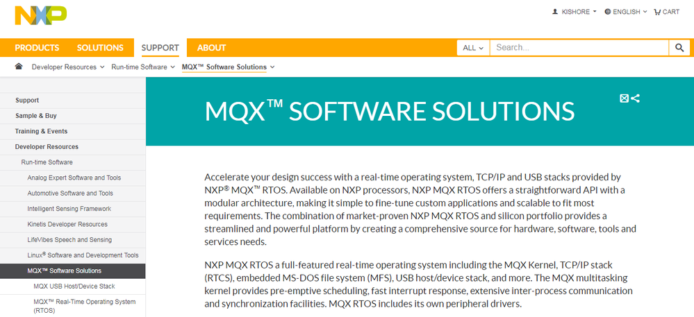

kishu306
Hello Mark,
   I see at the NXP Webpage with a column on MQX Support. Pasting the pic for your reference.
   Please confirm .
