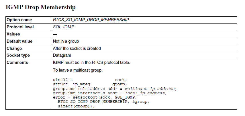

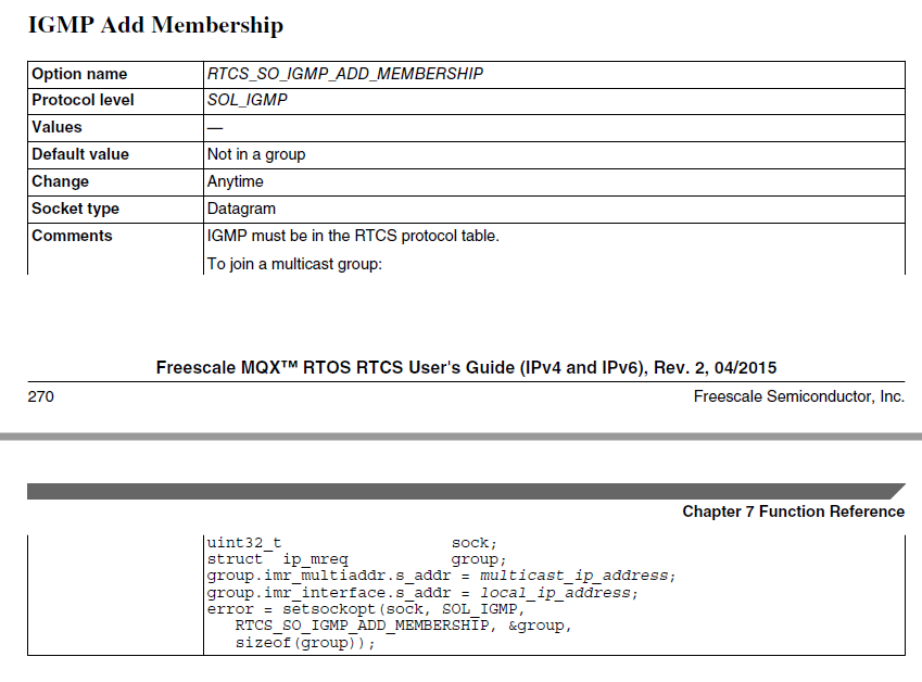

Hi David
You can use the setsockopt to do this.
For example, join a membership and leave a member ship
Please the MQX_RTCS_User_Guide.pdf for more details
