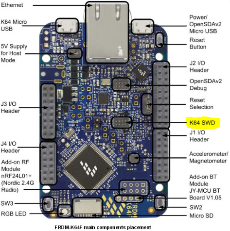

Hello Sudhakar,
The FRDM-K64F has a header for the JTAG interface. In the FRDM-K64F schematics you can see the connections. You don't need to change any jumper settings.
Earl Orlando.

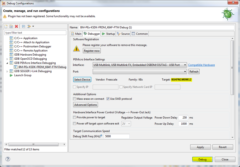

EarlOrlando
Senior Contributor II

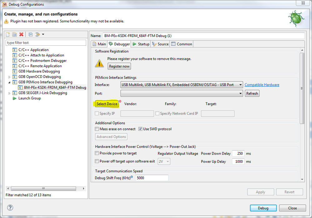

In KDS,
1. Go to the Debug Configurations... Menu
2. Double click over the PEMicro option.
3. Be sure that in the Main tab in the C/C++ Application: option is selected the path to the .elf file.
4. In the Debugger tab click over the Select Device button.
5. Select your MCU, in this case Freescale > K6x > K64FN1M0M12. Once it is selected click over the Debug button.
Earl.
