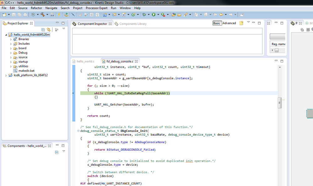

Hi Piotr,
Do you refer to the "C:\Freescale\KSDK_1.0.0\doc\Kinetis SDK K64 User's Guide.pdf"  ?
And does your KDS window as the same as me when debug ( the screenshot is mine )?
And for the J-Link debug for KDS , plase refer to "C:\Freescale\KDS_1.1.1\doc\pdf\kds_user_guide.pdf" .
Hope it helps
Alice

piotrek
Hello Alice,
1. If read my question I have KDS 1.1.1 with KSDK 1.0.0 installed. Nowhere there is a Freescale_MQX_4_1\doc\tools directory.
2. My screen looks pretty much like yours. What does it means?
I have rebuilt the project on another computer. It is Windows XP machine and the debug seems do be running fine. What I've noticed on the Windows XP machine is a message on the Console:
SEGGER J-Link GDB Server V4.88e Command Line Version
On Windows 7 64bit machine, where the debug fails, the message is:
SEGGER J-Link GDB Server V4.90e Command Line Version
3. What is GDB Server version on yours machine?
Piotr
