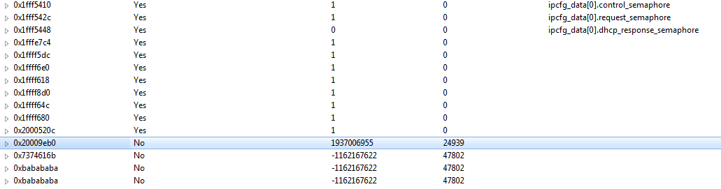

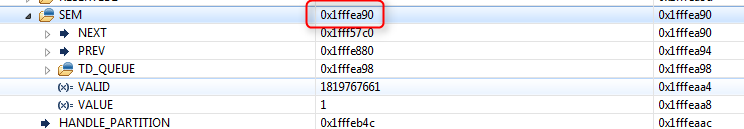

TobiasBystricky
I found out that the semaphore is not existing anymore:
In the semaphore overview the semaphore is not listed but a lot of semaphores with senseless content.
2,280件の閲覧回数
TobiasBystricky
The sem_destroy is in function _io_mfs_uninstall_internal at line 139
