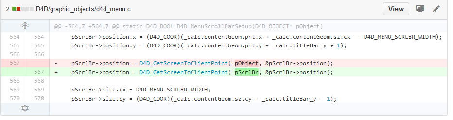

I'm trying to use D4D_Menu, according to the example in: d4d_screen_winmenu.c

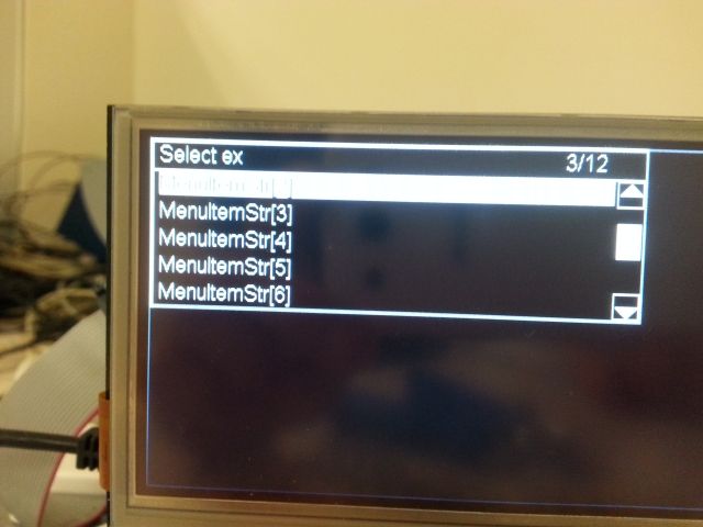

The D4D_Menu is fine when the position is: x=0,y=0.

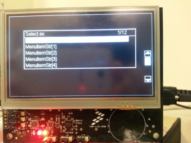

The problem when I define D4D_Menu with position: X=50, y=50, the position of the scroll bar is not aligned with the list box.
I'm using K70 tower and egui/d4d version3.
D4D_Menu with position: X=50, y=50, scroll bar with offset
I add fix in Git Hub:
