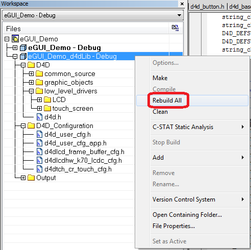

Please change the macro D4D_STRINGTABLE_PREFIX in the files "d4d_user_cfg_app.h" and "strings.h". Do not forget to rebuild the D4D library when you change something.
1. Change the macro D4D_STRINGTABLE_PREFIX in the files "d4d_user_cfg_app.h" and "strings.h".

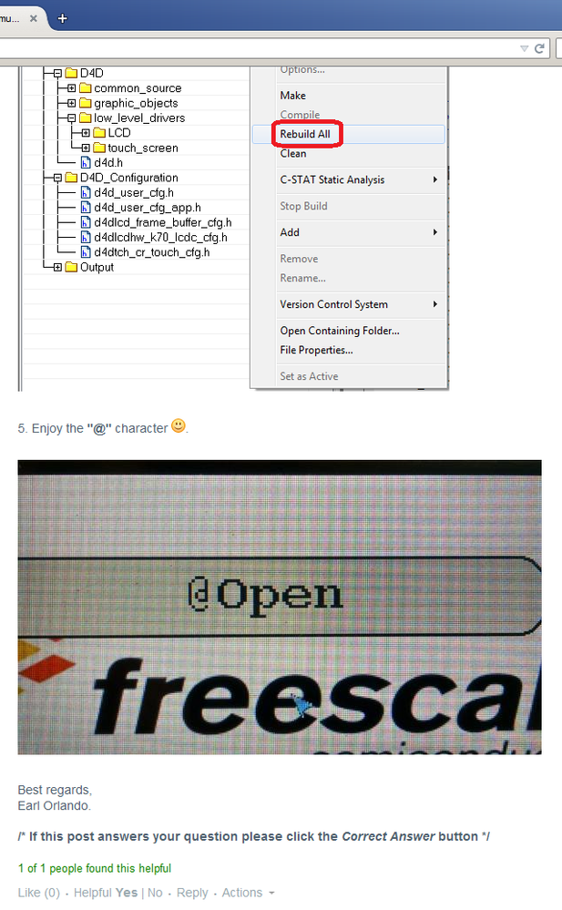

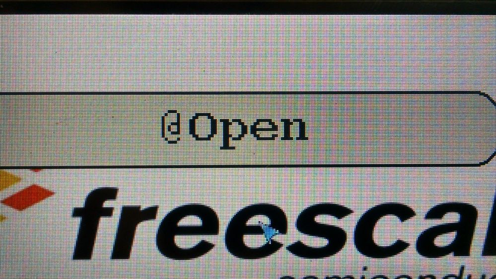

3. You can use the character "@" in the strings in the file "strings.c". For example:
D4D_DEFSTR("@Open"),               // D4D_STR_OPEN
4. Rebuild all.
5. Enjoy the "@" character Smiley Happy.
