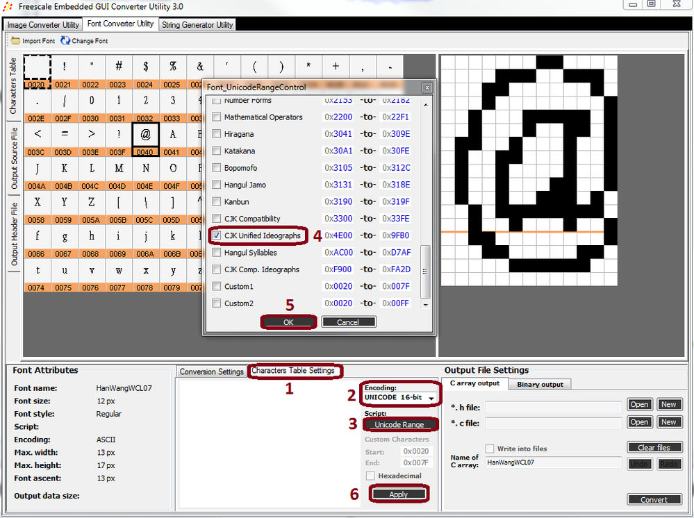

2) In the file "fonts.c" are declared the fonts "d4dfnt_CourierNew12_desc" and "d4dfnt_Arial12_desc". Its characters are described in that file through tables. These fonts are variables of the type "D4D_FONT_DESCRIPTOR" which is a structure where one variable is a pointer to the next page (const struct D4D_FONT_DESCRIPTOR_S* pNext). In the Arial and Courier New fonts are described the "normal" characters (the first table) and the Chinese ones (since the second page). So if you need a Chinese character you need to use one of these fonts, that's why I said that the "English" and the "Chinese" characters are linked by the same way.
3) You are right, it is a two-step process. I translated in Google translate the word Open (from English to Chinese Simplified), it trows more than one result (you can click in the translated word to see all the options) and one of these is 打开, if you go to the Unicode converter you can see that it Unicode is 0x6253 and 0x5F00, the same as the eGUI demo. I am afraid you need a good Chinese translator.

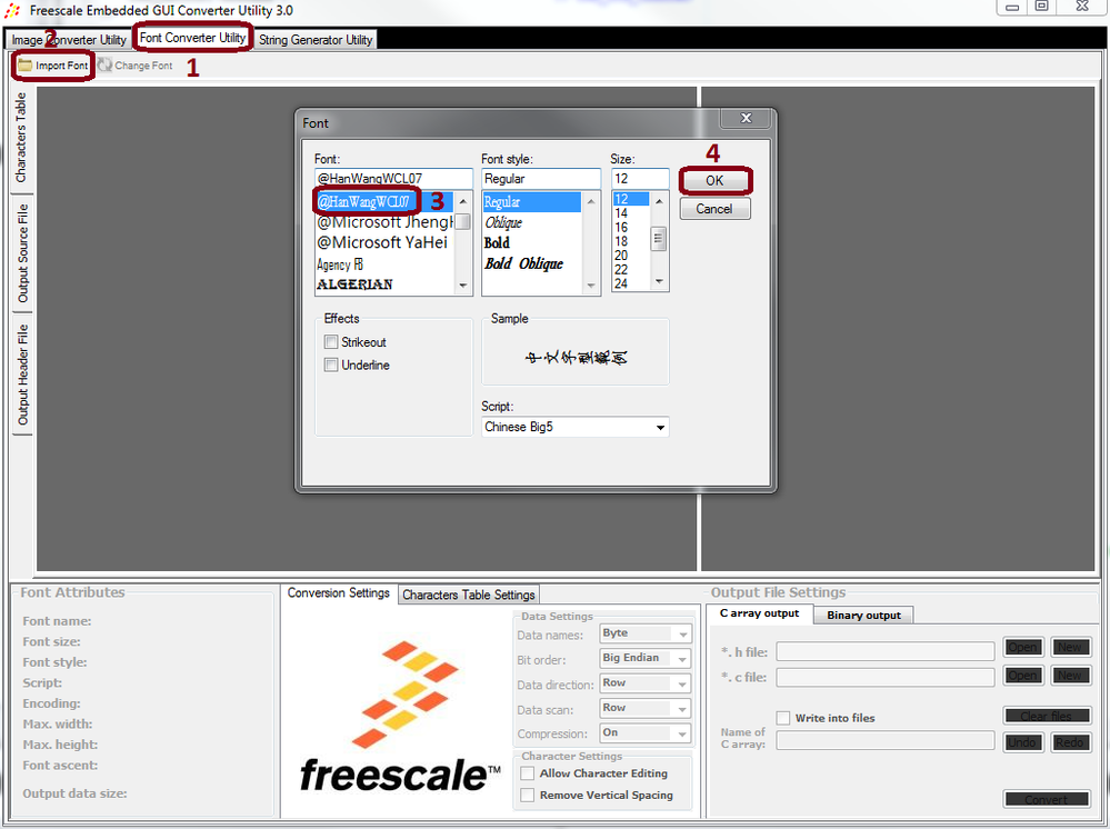

4) For the example I downloaded from  Cool Text: Download Free Unicode Chinese Fonts - this font which contains the Chinese characters. I installed the font in Windows and then in the "Freescale Embedded GUI Converter Utility 3.0" in the tab "Font Converter Utility" I imported the font (it appears as @HanWangWCL07).
Then in the tab "Character Table Settings" select "Unicode 16-bit" encoding and press the "Unicode Range", select the option "CJK Unified Ideographs" which are the fonts from the 0x4E00 to 0x9FB0 Unicodes, then click "Ok" and "Apply".
pastedImage_8.png.
Nos, you have all the Chinese characters in the main window, you can go through pages in the menu shown in the image. For example, if you select the page 95 you will see the character 开 (which is used in the wor "Open") with the Unicode 0x5F00.
Now you can create your .d4l file or a .h and a .c files which the data that you need.
pastedImage_8.png.
