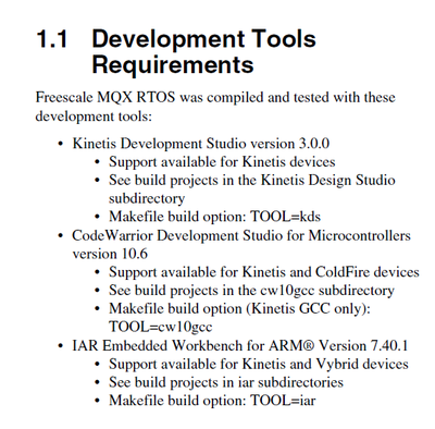

Hi @m4l490n :
From the release note, the development tools for MQX 4.2 is :
MCUXpresso IDE is not in the list.
MQX v5 can support MCUXpresso IDE.
7,211 Views
