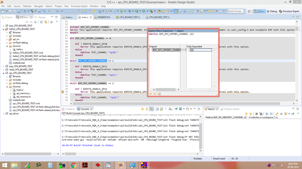

I found strange thing which is like a bug in KDS. In the spi example there is a part of code to define the memory channel:

I have defined the macro  #define BSP_SPI_MEMORY_CHANNEL              (1)   in the <board>.h file but look at this screen shot. When I right click on SPI_MEMORY_CHANNEL and click on explore declaratio I found this. That is the macro defined for memory channel two.But I have defined it as 1 in bsp files why is this happening please help...

Hi Yadhukrishnan:
Did you make clean all and rebuild your BSP ?
If you still think BSP_SPI_MEMORY_CHANNEL not right, I suggest you  print out this Macro to check it's real value

Hi danielchen@fsl‌
I did what you said and I got BSP_SPI_MEMORY_CHANNEL as 1. I did the spi example in different computers and I got the same read error.

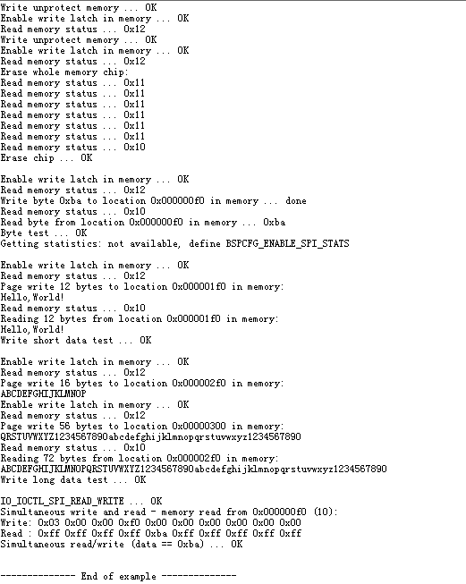

danielchen
I tested this demo with TWR-K65F180M, TWR-K60D100M, TWR-K60N512, not found issue, please see the picture , this is tested with K60N512.
Since you are using your custom board,  I suggest you check the 4-wire SPI connection. Does your SPI1 routed to the Memory board correctly?
I checked your error message, it seems the SPI read operation is not right. I remember you are using W25Q64 spi flash, I think you need to check the SPI serial memory instructions from the datasheet, maybe you need to modify them according to your custom board.

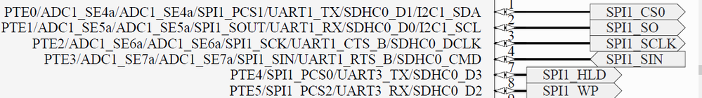

yadhukrishnanvm
danielchen@fsl‌ I am sure the instructions are same,I have checked the datasheet.I am using W25Q64FV spi flash device in the custom board.
Now I think the routing of spi1 is not correct.I defined the pins in init_gpio.c as below
case 1:
/* Configure GPIOE for SPI1 peripheral function */
pctl = (PORT_MemMapPtr)PORTE_BASE_PTR;
pctl->PCR[1] = PORT_PCR_MUX(2); /* SPI1.SOUT */
pctl->PCR[2] = PORT_PCR_MUX(2); /* SPI1.SCK */
pctl->PCR[3] = PORT_PCR_MUX(2); /* SPI1.SIN */
pctl->PCR[0] = PORT_PCR_MUX(2); /* SPI1.PCS0 */

yadhukrishnanvm
danielchen@fsl‌
These are the pins I am using in the custom board.

danielchen
Since you are use PTE4 and PTE5  as  SPI1_HLD and SPI1_WP,   did you configure PTE4 and PTE5 ?
