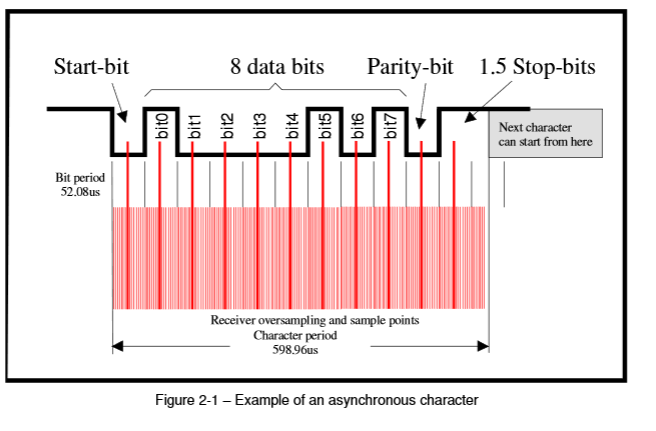

mjbcswitzerland
Specialist V
Nitin
The UARTs are "asynchronous" which means that they 'need' to match the baud rate of the data being received. Also the parity and stop bit settings must match.
The receiver detects a start bit, samples 8 bits of data, the optional parity bit and a number of stop bits. Then it waits for the next start bit.
The Tx generates a start bit (with one Baud period), adds 8 data bits (those received) then adds an optional parity bit, followed by one or two stop bits. Then it is ready to send a following character.
Therefore you have no choice but to set the UART characters accordingly otherwise it will sample in the data content incorrectly and also send it on at a Baud rate that the destination will not understand - On top of that, it its parity setting is wrong the destination may also declare reception as with errors.
In your case what you need is a possibilty to switch the input to the output using a logic circuit and not via UARTs Rx/Tx.
Mark

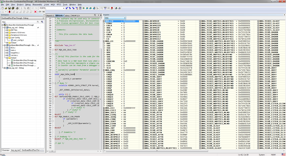

nitinharish
Contributor V
mjbcswitzerland​

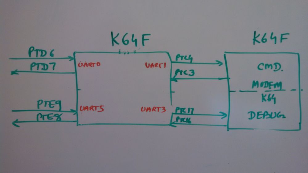

This is my scenario:
I am writing SW for the Red font K64F and it is just a bridges between 2 processors.
Initially I thought, I will use DMA with UARTs and it should be done, but it seems from your valid points that it will need me to know the baud rate.
But my problem is, I will NOT know the baud rate, so, I thought let me configure all PINS as MUX 1 so that they act as GPIOs and then via IRQC value of 1 on PORTx_PCRn registers, I can trigger the DMA.
This is the code, I have come up with, but it does NOT work. Thoughts ?

mjbcswitzerland​, after your feedback, this is what I came up with, but still NO data transfer is happening at all:

This is my DMA register status:

mjbcswitzerland
Specialist V
Nitin
1. Your source destination sizes are not correct - they should be 32 bit and not 8 bit.
2. DMA_TCD2_NBYTES_MLNO must be 4 and not 1 since it is the count of bytes in the transfer (4 bytes in the long word)
Beware that you can only trigger from one input per port (your UARTs 1 and 3 are on the same port so you should look to see whether you can move one to different pins). The reason is that you have only a "port A", "port B" etc. trigger and not one that can be selected per pin in a port. If you have port C selected for two DMA channels, both will trigger each time there is a change, which would give false output toggling on one of them.

It marks PORT C toggle Register as the destination for DMA but what I want is PIN NOT PORT to toggle, How is that achieved ?
On simlar lines, I have my code here (See RED comment below):
//I WANT TO SET PTE 8 as my destination, how do I do that ? ? ?
