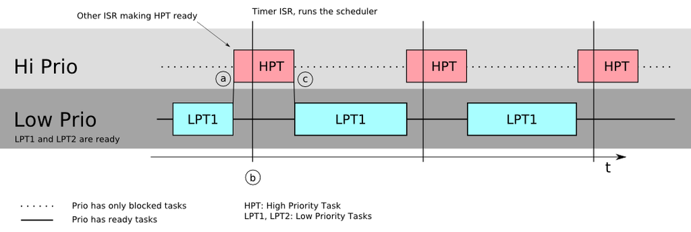

The Issue
Consider the situation depicted in the figure. We have tasks running at two
different priority levels, high and low. The High Priority group contains
one task which waits on an event, does some work and then waits on the
same event again. The low priority task group contains two tasks, dubbed LPT1
and LPT2. LPT1 is a long-running task, possibly being always ready. LPT2 is
another low prio task which is ready. Since it is never running in the figure,
it is not depicted graphically. We are running an MQX scheduler with time
slicing enabled and both low priority tasks have time slicing enabled.
When the situation depicted in the figure persists, there is no fairness in
the low priority task group. The time slice of a task is only ever incremented
in _time_notify_kernel() which runs during the timer interrupt service routine.
This point in time is marked (b). Shortly before the timer ISR is run, a high
priority task is made ready and consequently the dispatcher runs the
high priority task. This point in time is marked (a). Shortly after the timer
ISR, the high priority task again becomes blocked. Consequently, at (c), the
dispatcher runs the task at the head of the low priority ready queue, LPT1.
When _time_notify_kernel() runs at (b), it increments the time slice of HPT, if
applicable. The time slice of LPT1 is left untouched. As per the figure, if
the HPT is always running when the timer IRQ is asserted, the time slice of
LPT1 will never be incremented. Thus, LPT2 will be starved.
Triggering the Issue
We have a number of setups that exhibit the described problem. We have the
scheduler interval set at 1ms. The scheduler is called by the timer ISR, which
also runs every 1 ms. We have a bus system requiring service by a high
priority task every 1ms, nominally. The timer runs on a local oscillator,
whereas the bus service interrupt is timed through the bus. Effectively this
means that the bus interrupt runs off some other clock source. We have low
priority tasks which are ready for long periods of time, corresponding to LPT1
and we have other low priority tasks such as LPT2. The phase between HPT
becoming ready and the timer IRQ being asserted slowly drifts, according to
the beat frequency between the oscillator frequency and the oscillator
controlling the bus services. When HPT is running between two timer ISRs, we
see normal system behavior. When the HPT is running when the timer IRQ is
asserted, we see large latency for LPT2. In practice we see the system running
as expected for e.g. 50 seconds, then be unresponsive for the next 15 seconds.

We are thinking about changing 1.) Our changes would look as follows: During
all (a) like transfers of control from a low prio task to a high prio task we
increment the time slice of the low prio task by one. At (b), in
_time_notify_kernel, we do not only check the time slice of the task at the
head of the active ready queue, but we check the time slices of all the tasks
at the heads of all the lower priority ready queues as well. This pretty much
assures non-starvation in the lower prio task group, albeit at the cost of
tasks receiving potentially very short time slices.

If scheduler works as you described, it looks like a bug.
When time slicing is enabled for both low priority tasks, these tasks have to alternate in running.
I reported it in our internal bug database and designers will analyze that.
