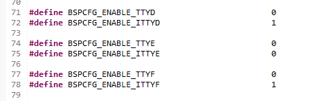

DavidS
Hi Shiju,
I suspect your board header file or user_config.h isn't setup correctly.
For this example (again I'm using the TWR-K60D100M[newer silicon] but should be same for TWRK60N512[older silicon]).
Please verify that you are getting the "hello" and "world" printf's working first that output via the TWR-SER card.
The OSBDM serial interface is the input and should be able to echo the OSBDM character to the TWR-SER card.
Once you have verified the two headers above have been configured correctly, clean your RTOS and re-build it, then re-build your hello MQX application and test.
twrk60d100m.h
David
