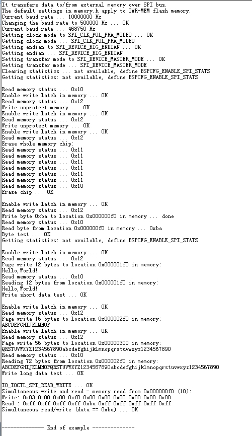

danielchen
I think you need to check the jumper settings in your TWR-MEM board.
J4:  Serial Flash Configuration options 1-2
J14:  Serial Flash Chip-select  1-2
Please see my console output. I tested with TWR-K65F180M and TWR-MEM board
