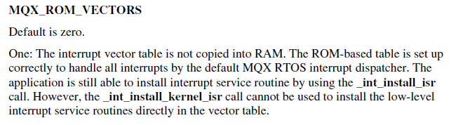

Please note there is a macro MQX_ROM_VECTORS in user_config.h
You can set MQX_ROM_VECTORS macro = 0 in user_config.h and rebuild bsp and psp. This will relocate vectors in RAM
