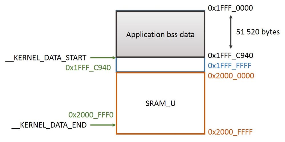

I am working with TWR-K60D100M.
Stack Size I have used for Tasks is 21KB (Calculated from TASK_TEMPLATE_STRUCT, also seen from MQX Stack Usage).
Main Application BSS RAM is 34KB (seen from .MAP file).  So total RAM used is 55KB approx.
I declared some more variables then build the project and Study  .MAP file, that indicates Main Application BSS RAM is 62KB...And if I load that project it is stuck !!
From TWR-K60D100M User Manual I come to know that RAM Size is 128KB. Then why this is happening?
Is K60 RAM is divided under SRAM_L and SRAM_U of 64KB ? If yes then how can I access both RAM segments ? What changes I have to made in Linker File....?
Why I am not able to utilize 128KB of RAM?

Hello Utsavi,
Let me explain what I think is causing the problem and then you can do next test.
If you remember, SRAM is divided into 2 x 64-kB lenght blocks and they are accessed from different buses so we have to be sure that any object (variable, structure) is not stored by overlapping both sections, for example, next imagen shows a scenario where a 32-bit variable is stored between these blocks:
In this case, there would be an access problem and program would crash. Remember that this could be avoided in compilation-time although it is difficult to prevent this on run-time
Now, by analyzing your map file, this is how your memory is used:
You application data (like .bss objects) does use 51 520 bytes, after this, there is a segment called __KERNEL_DATA_START that signals where KERNEL will start to use data for stack or heap from different tasks. What i think could be causing the crashing is the fact that kernel could allocate any objetc in the limit of both SRAM sections, so we can make a quick test to validate if this is the problem or you are really using all the RAM in your project.
I'd recommend you to move the __KERNEL_DATA_START address to 0x2000_0000 although the left ~13kB of SRAM_L would get unnused, but this way we can be sure that kernel will not allocate memory in the middle of both sections:
For doing this, you will need to modify your linker file (located at: <MQX_4_0_PATH>\lib\twrk60d100m.cw10\debug\bsp) and add next line in memory segment:

And also, modify:
.kernel_data :
        __KERNEL_DATA_START = ALIGN(0x10);
    } > start_of_ram_u
As you can see, a new section called start_of_ram_u is added and __KERNEL_DATA_START should be place at this segment, this way, MQX's kernel will use all available memory in SRAM_U and we can be sure that no object will be stored in the limit of these sections.
Please take in mind that this linker files will be overwritten if you re-compile bsp library, so, modify the linker file every time you compile bsp library.
You can make this test and corroborate if program still crashes, if so, probably your are consuming all availble SRAM.

isaacavila
Hello Utsavi,

And also, modify:
.kernel_data :
    } > start_of_ram_u
