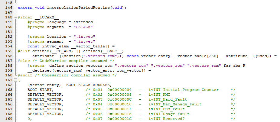

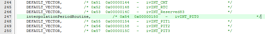

vuklesi
Daniel,
I am still having trouble with this. So, I have modified the vector table in vector.c as in these screenshots:
Additionally, in one of the single-shot tasks, I call:
_int_install_kernel_isr (INT_PIT0, interpolationPeriodRoutine);
_bsp_int_init ((IRQInterruptIndex)INT_PIT0, 0, 0, TRUE);
But this does not give me the ability to run my application after restarting the board. If I remove the call to _int_install_kernel_isr, and leave only _bsp_int_init, then my ISR never gets activated, which makes me think that I am not modifying the vector table correctly. I should probably note that I do rebuild MQX projects after changing anything in the vector.c file. Could you please point out what am I doing wrong?

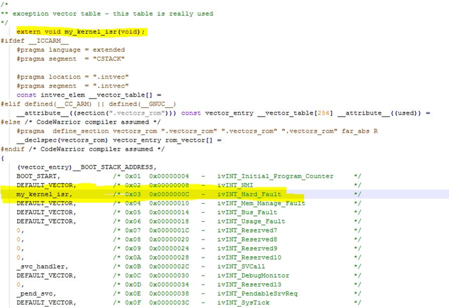

vuklesi
Daniel,
Thank you very much for your help. I use the fromelf image converter to produce a .bin file at the end of building my project, which I copy to the flash memory of K64F.
Thank you for the screenshot. I suppose I should supply the name of my ISR for ivINT_PIT0, not ivINT_Hard_Fault. However, I also need to set the NVIC correctly, besides manually changing the vector table, right? I have tried just calling _bsp_int_init((IRQInterruptIndex)INT_PIT0,1,0,TRUE); but that does not work. Could you please explain what else do I need to do besides defining my ISR and adding its name to the vector table?

danielchen
Please refer to the below code
