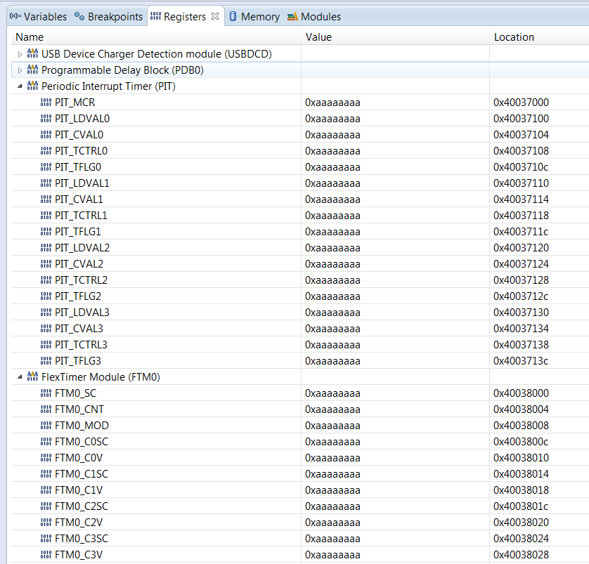

Hello.
In most of the registers appear in this way.
Can anybody help me?

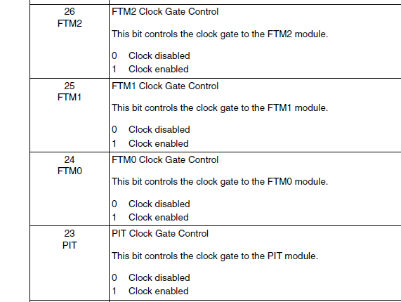

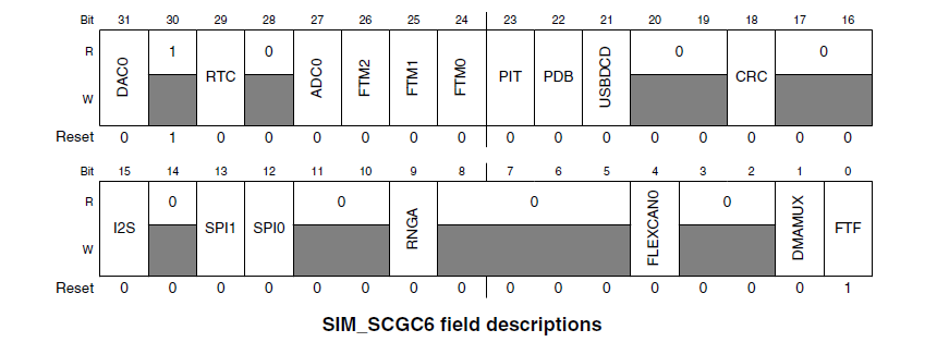

I think you need to enable PIT clock gate control, and FTM clock gate control, then you can see the correct register values.
SIM_SCGC6 |= SIM_SCGC6_PIT_MASK;
Please refer to the reference manual for more details about SIM_SCGC6.
