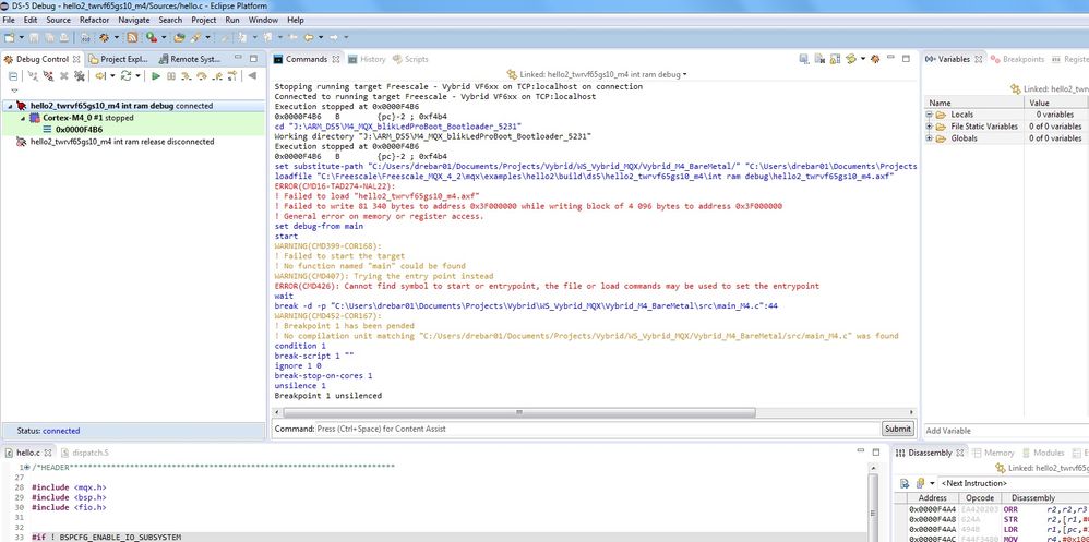

I am using win 7 64bit with MQX4.2 and DS-5 5.23.1(32bit). I am able to build project and it is working when I upload *.bin files to SD card (MQX on A5 and Baremetal project on M4). But I am unable to debug bootloader from your examples (bootloader_vybrid) on A5 there is always error (picture attached). I can debug both applications for A5 and M4 core but not bootloader.
I have tried same bootloader example under Linux (Ubuntu 14.04 LTS 32bit, MQX RTOS 4.2.0 and linux version of DS-5 5.23.1). On Linux version of DS5 is no problem to debug bootloader and it is fully functional. Do you have any idea why is it not working on windows?DS5.jpg

Let me try to find the reason of the problem.
Have you tried with a different DS-5 version?

I have ran project on different PC with Win7 32bit and with installation MQX4_2 and DS-5 v5.23.1. Project behaves same way as in previous cases. I am attaching my project, which gives me error when I run it in debug mode. Do you can run it on Tower at your office? Do you can check if project settings is ok? I am attaching user_config as well. With PSP and BSP would be zip too big.

I have tested my project with older version of DS-5 5.22. It behaves same way. When I import same project to Linux and its version of DS-5 and I just change all necessarily paths I am able to debug it without problems.
I have no idea what to do next.

I will try different version of DS-5 at weekend. I have tried only different MQX4.1_Vybrid. With that it behaves same way. Same version of DS-5 just for Linux with MQX4.2 it is working just fine.
I think it is problem with debugger or file that it uses for its settings probably from MQX4.2. I can transfer my compiled code to SD card and run it. When I use Baremetal project I am able to debug it, transfer it to SD card and run it. Yesterday I was working with that Baremetal project and it works fine but when I ran this project today it is behave same way as other projects. I have few Eclipse based IDE's. I am using these IDE's each for different type of project. Is it possible that this could be the cause? Could they affects its settings for projects or for them selfs somehow?

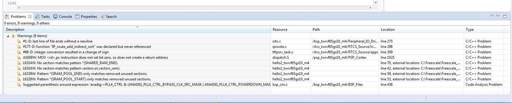

I am attaching warnings and errors from different example project with MQX4.2, DS-5 v5.23.1 win7:

I have tried one more thing. I have ran new project with dual_core_ds5_m4 example. This project occasionally run in debuger correctly. I have tried various combinations of HW interconnection (different USB port, shorter cabel, unplug USB before every run,...). I still don't have clue what could go wrong. Below is attached output for both cases:
