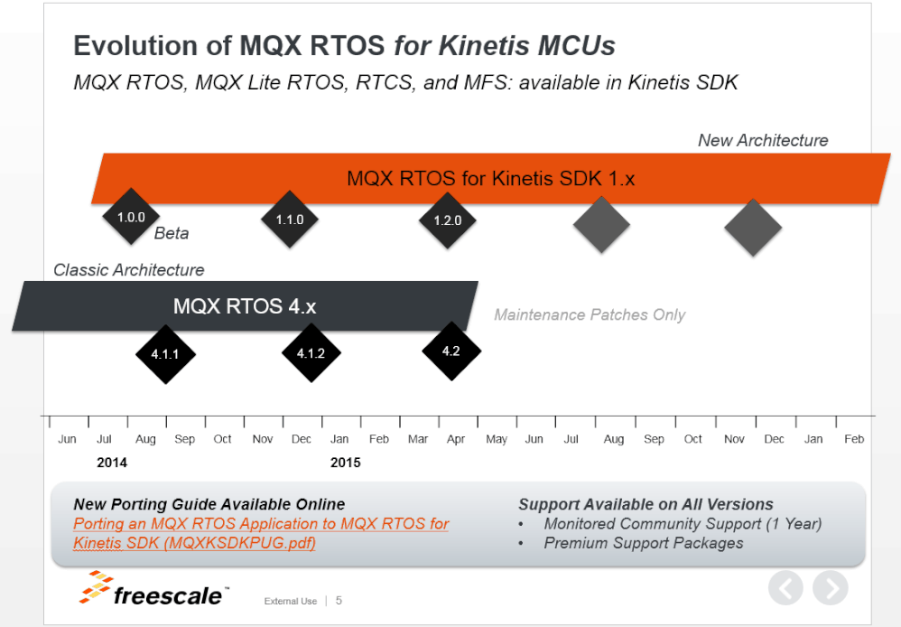

marcelovaranda
Hello Soledad,
I was using MQX 4.1.1 and I was advice to migrate my development to KSDK 1.1 as MQX would not be available outside the KSDK.
Now, according to your post, I see that MQX will continue to "grow".
Could please elaborate the differences and roadmap for both KSDK and MQX? I am finding many problems with KSDK in components that I had pretty stable on 4.1.1.
Marcelo

DavidS
Hi Marcelo,
The Kinetis SDK version of MQX RTOS is the future. As I will mention in a second we have an upcoming release of MQX classic (version 4.2), but that is the last planned release in that line.  The development resources are shifting over to MQX RTOS for Kinetis SDK.
We wanted to have some overlap period to help with software stability and ease the transition for customers.
Also to ease the transition we just released a porting guide which detailed how to port applications written for MQX classic to the new architecture.
IMPORTANT NOTE: Support for
NEW Kinetis MCUs will no longer be added to the traditional Freescale MQX RTOS (v4.x) releases. These new Kinetis MCUs will be supported instead by MQX RTOS for Kinetis SDK releases.
Support and maintenance will continue to be available for traditional Freescale MQX RTOS for a limited time. We will continue to offer premium support packages and professional services for all versions.
Hope this helps.
David

marcelovaranda
Thanks David, understood.
Will FFS be available on the next release of KSDK? I guess there is only support for USB and SD Card based FS on 1.1, correct?
Thanks in advance,
Marcelo

DavidS
Hi Marcelo,
FFS is TBD for KDS/KSDK.
Please go to the top MQX Community page and take the MQX Survey to give your valuable feedback.
MQX Software Solutions
There is a link to SurveyMonkey:
Freescale MQX RTOS Survey: February 2015
David
