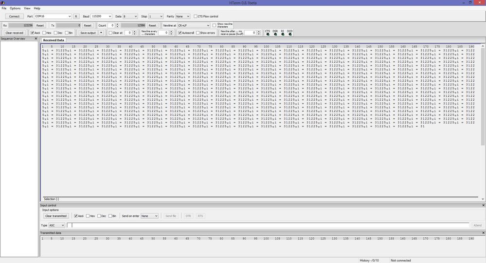

I am using codewarrior 10.5. I have created a new MQX Lite project. In that I am using Console_IO PE component. When I tried printing string it works well. When I tried printing integer values, I noticed some strange behavior. i.e
1. "\n" is not working when using at the end of a string.
2. For the following program, the values are coming abruptly

the o/p I am getting in terminal window is
I am using K60 uc. The above o/p is for one shot. i.e it repeats each time after _time_delay_ticks(1000);

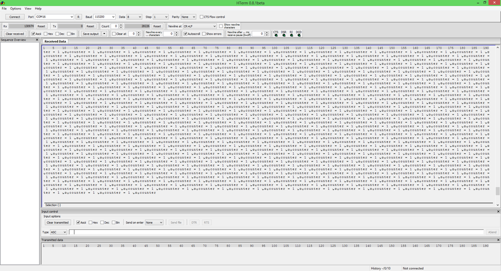

I made a new MQX lite project and checked. I have attached the project. I think the uc is restarting. I wrote the same code for without MQX project and that is working fine. here the o/p is

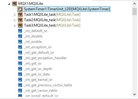

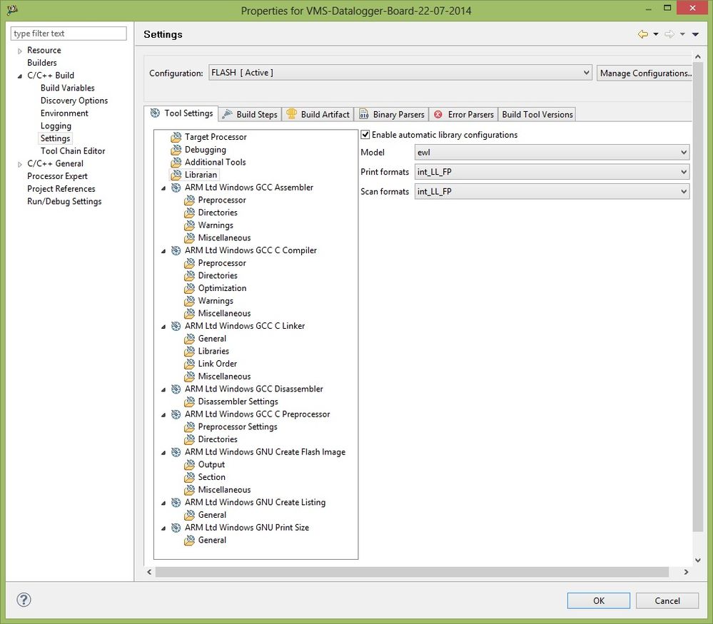

I figured the issue but don't know how to resolve it. While debugging, The progrm was going to PEDebughalt (the uc was restarting)so on further investigation I found the issue was of _time_delay_ticks(100); on removing this line and using WAIT component of Erich Styger resolved the issue. One more issue I had was I wanted to print floating values to terminal so I used the following configurations.
So these 2 issue were there, which made the uc to restart.
The program I have attached had the _time_delay_ticks(100); issue.
The Floating point setting was found in the other program(MQX_Lite based). So my concern is how to resolve these issue? as I want ms level precision in my project and I will be logging data in SD card with ms i.e HH:MM:SS:ms format so I was thinking of using the system timer 1 i.e

thanks for quick response  I followed your instructions. I think the device is restarting by it self.
the result is as following
