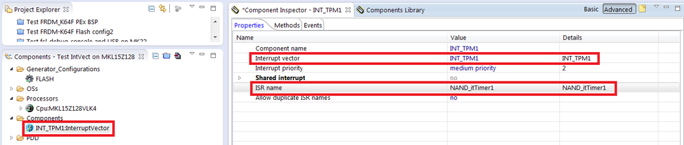

You can use the InterruptVector component (in Processor Expert) that put the requested interrupt service routine into interrupt vector table. See below:

Thank you
it's perfect !
