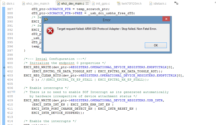

I have done the change as you mentioned but it does not work for me. Also I defined  HIGH_SPEED_DEVICE to 1 in usb_descriptor.h file. While debugging I found that code flow lost after executing the following lines in file ehci_dev_main.c ( line 403) .
    /*--- Intial Configuration ---*/
    /* Initialize the endpoint 0 properties */
    EHCI_REG_WRITE(dev_ptr->REGISTERS.OPERATIONAL_DEVICE_REGISTERS.ENDPTCTRLX[0],
        (EHCI_EPCTRL_TX_DATA_TOGGLE_RST | EHCI_EPCTRL_RX_DATA_TOGGLE_RST));
    EHCI_REG_CLEAR_BITS(dev_ptr->REGISTERS.OPERATIONAL_DEVICE_REGISTERS.ENDPTCTRLX[0],
        0 ); //(EHCI_EPCTRL_TX_EP_STALL | EHCI_EPCTRL_RX_EP_STALL));
After that when I pause the debugging I got a following error
Please let me know if anything else I want to change in BSP.

Hi Pramod, I too followed the instructions and made changes in twrk70f120m.h :
#define USBCFG_DEFAULT_HOST_CONTROLLER    (&_bsp_usb_host_ehci0_if)
and I'm facing the same issue as you during debug. Have you got it to work ? What changes did you make ?
2,032 Views

Important note:
Be aware. Some of ULPI signals are shared with JTAG trace signals!
For debugging please use onboard OSBDM interface or use just 10wire connection (without trace signals) with your external debugger!
I hope it helps you.

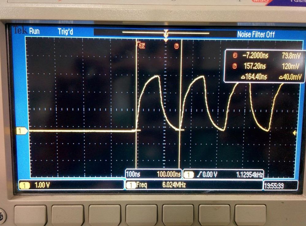

I am working on a custom board. NOTE that khci works fine on my board, but USB is really slow.
Can I assume that USB is really getting 48MHz ? How can I confirm since there is no clock on a pin for USB unlike SPI.
Any other suggestions ?
2,032 Views
reubennoronha
Above is the USB-N pin captured on CRO. It seems to be about 6MHz, which is 8 times slower than 48MHz.
NOTE that this code is khci since I reverted the changes made to the file since ehci does not work..
