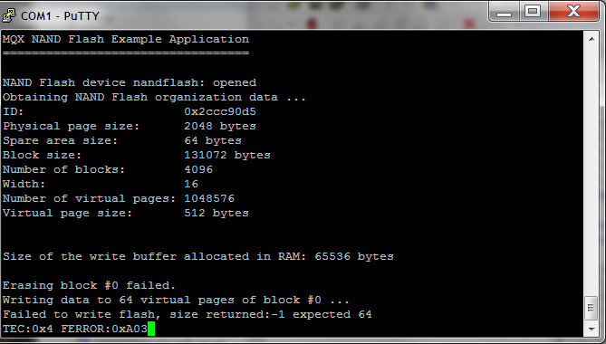

Hello everybody,
I'm trying to migrate my MQX / Vybrid / IAR project from TWR-VF65GS10 to Phytec PCM052.
I think the original BSP for TWR should work but it doesn't.
There are issues with NAND flash that is used to implement a FFS drive and also with the USB.
Is there anyone using this board with MQX?
My compiler is IAR.
MQX 4.1.1
thank you,
rendy

Which PCB version of the SOM are you working with? For example, 1374.0 or 1374.1?
There is an errata note for the 1374.0 PCB regarding NAND flash. See E02 here: http://phytec.com/wiki/images/c/c8/Errata_052_A0.pdf

Another important question is: since the connections between NAND and Vybrid are exactly the same as in TWR, why the example 'nandflash_twrvf65gs10_a5' does not work in PCM052?

Yes, my SOM is 1374.0!
I did the workaround and the NAND example worked fine.
I can not understand why we were not advised about this before.
Thank you Serah.
