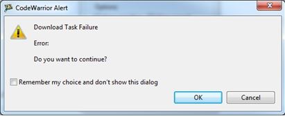

- If I try to run the project at this point I get this error screen after it programs the flash:
- As you can see there is no error listed, it just says :error
- This is what the Consol show:

Now I would expect that I would have to change the debugger in some way i.e.

I fixed it.
I fixed it!!!!!!!!!!!
1. "Perform standard Download" must be selected AND the target task must be enabled
2. You have to modify the target task so that it restricts the range to only 0x00000000 to 0x00007FFFF otherwise it tries to program / verify from the flash range which causes the unknown error.
Freescale need to fix 2 things
1. Target task default restrict range to flash range
2. fix the error message that indicates the exception out of range (or what ever) has happened so its not a blank message.

Hi David,
I have contacted them and directed them to this thread, hopefully someone helps me soon, this is critical.
2,866 Views
CarlFST60L
Senior Contributor II
I fixed it.
2,865 Views
