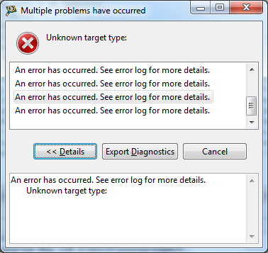

I've been running my application on a Windows 7 PC for a number of years without any problems (including backing up the source code and keeping the original installation programs).  The PC has died and I wanted to move my development tools to another (Windows 7) PC.
This MQX 4 for CodeWarrior 10.4.  I install MQX followed by CW, when CW comes up for the first time, I do all the updates.  I've copied in my project folder from the previous system.
When I start up CW, I get the "Start Multiple Errors" dialog box that's below.  There's no useful information other than saying "Unknown target type".  I've looked through "Properties" in the project and I can't find any setting for that - I would have thought that information would be copied in with the project.  I've sent this in as an issue to NXP as well.
When I try to build, everything seems to compile okay but the linker upchucks with:

I suspect that it's not bringing in the correct bsp (I created one for the project).
Can anybody point me in the right direction to get these builds working?

SUCCESS!!!!
I was able to review my notes from five years ago (something that I wanted to avoid) and go through the process of recreating the BSP.  Over the past month, I've been going through and reviewing the process and testing it so I'm very confident that it works.
I've attached the document that I created for creating the BSP if anybody is interested.

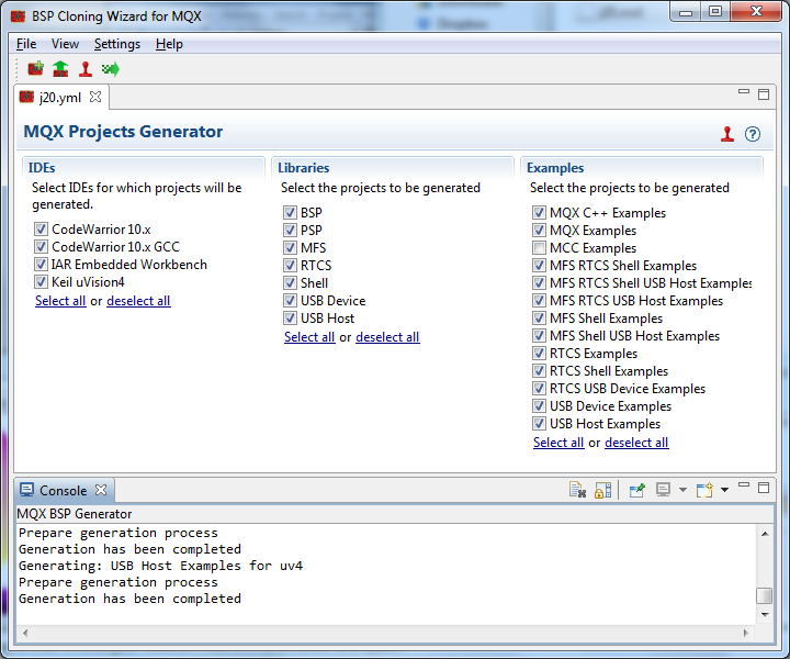

Okay, I'm moving forwards - two steps forwards but one back.
Using BSP Cloning Wizard, I created a new BSP based on TWRK60D100M and then modified it to match the original BSP using "Freescale MQXTM RTOS BSP Porting Guide" (Document Number: MQXBSPPG) and then clicked on "Generate MQX Projects".  All good and I'm comfortable with the changes I made before generating the MQX Projects.
Here are the results of Cloning Wizard and I've attached the Console Log for generating the projects to this post):

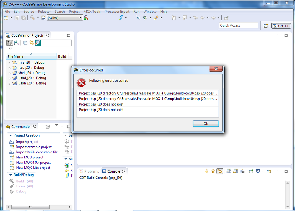

Next, I went back to CW to drag in the .wsd file for my bsp named "j20" (from Freescale_MQX_4_0\config\j20\cw10) and I got this:
I would have thought that the bsp/psp would be included here.
Can anybody point me to what I'm doing wrong?
Thanx,
myke

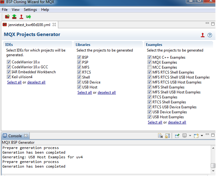

Hi Myke,
I performed the same test. But there is no error message from my side.
video is attached.  Can you please try again?
Jennie Zhang

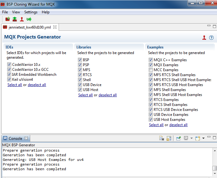

ZhangJennie
Hi Myke,
In your step 3, you modify MQX files. I don't suggest you do this. You don't need modify anything.
then click on "Generate MQX Project". to generate .wsd serials of files. then import .wsd as I showed in my video. Build BSP and PSP. there should be no error.
I suggest you try this basic steps first to guarantee your basic system procedure is correct.
Best Regards
Jennie

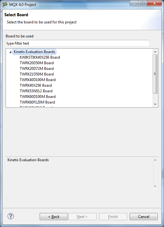

Okay, I've run through Steps 1. through 8. without any issues.  I was able to build the bsp and psp without any issues.
Now, I want to bring in my project files (Step 9. above - the one I was pretty sure wouldn't work).  As I indicated above, I am expecting to be able to create a new project and have the board type show up.  But, when I try to do that, the new/cloned "j20" board type does not show up in the list of Kinetis board types (this was the problem I was expecting):
2018.08.18 - Imported j20.bsp build results - How to add Board to Project.png
What do I do to bring in the board files (bsp, psp, etc.) into the list of boards to select from the project.  When I read through MQXBSPPG, this isn't explained (actually, if you read the document, the approach I took before, updating the board files *before* importing to CW seems to be the correct way of doing things).
Thanx - I know we're almost there,
myke

Well, one step forwards but still a ways to go.
I did the following:
  1. Took down and then reloaded CW followed by MQX (including loading the updates).
  2. I then ran BSPCloneWizard and created the new bsp.
  3. Next, I modified the changed files in Freescale\Freescale_MQX_4_0 so they matched the original bsp.
  4. I then restarted BSP Cloning Wizard and generated the projects (no errors).
  5. Next I was able to import the bsp (as you showed in your video, thanx again) without any issues.
  6. I then tried to build the project files, but only the psp would build correctly.  I tried the bsp with c9x and ewl (no differences).  I've attached the console logs of the build attempts.
  7. On the off chance that things would work if I created a project, I tried to create a "New" project, but the bsp wasn't listed.
What should I try next?

myke_predko
Senior Contributor III
Okay, I've tried to creating a new project folder to see if I can create a new project and copy in the source and build from there.
When I try to create the new project, my bsp doesn't appear as one of the target systems - I tried to copy in the contents of "Freescale_MQX_4_0" but it still isn't finding the target system.  I'm trying BSPCloningWizard but it's failing with a Java code 13:
Can anybody help point me in the right direction?  I feel like I'm 95% of the way there, I just need to get pointed in the right direction.
Thanx!
