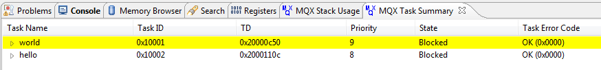

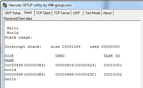

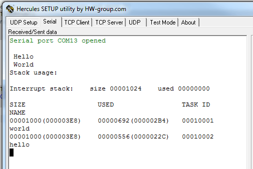

I just dusted off my M52259DEMO, updated the OSBDM driver, used MQX4.0 (quite the typo you had before....took me a bit to find MQX3.4 to test with ;-) ) and re-tested.  All is working.  Note that TAD worked fine before _klog_show_stack_usage();, then stopped after stepping that statement, then after stepping _task_block(); TAD was back alive.
