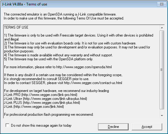

Now go back and build httpsrv.  You shouldn't get any errors.  At this point, you need to change the IP address of the K64F.  This is found in config.h.
To debug/run the application, right click httpsrv in the project view, then go to Debug As.. -> Debug Configurations.  Double-click the "GDB SEGGER J-Link Debugging" node and it will auto-generate a configuration called "httpsrv_frdmk64f120m In Flash Debug" with all of the relevant information auto-populated.
Click Debug.  You'll know it's working if you get this dialog:
Ignore this warning:
The debugger should have started in the paused state in main.  Just click the Run icon to continue running.  If you ping the IP that you had specified in config.h, it should work.  In addition, you should be able to reach the mbed device via a web browser!
