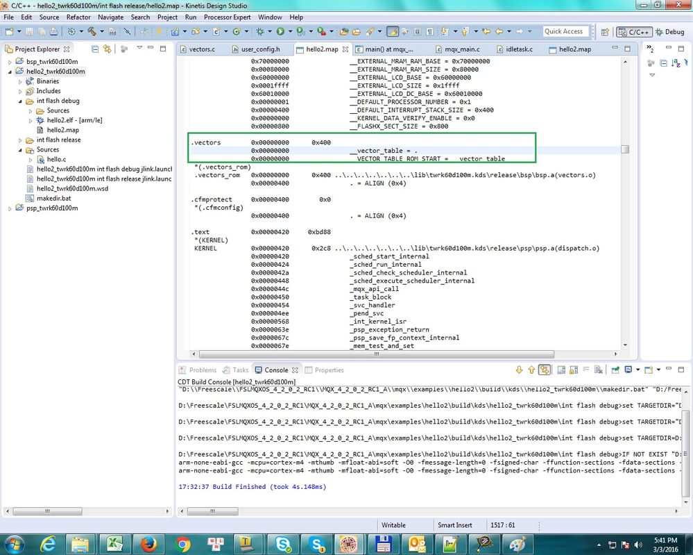

According designers:
It can be resolved by adding extern __vector_table to linker file:
EXTERN(_cfm __init_hardware __vector_table)

RadekS
Thank you for your bug report.
I tested it and you are right. When we comment out flash configuration, result hex file don’t’ contain also vectors.
Unfortunately I didn’t found reason for that behavior.
I reported it into our internal bug database.

RadekS
Hi Z.q. Su,
Unfortunately, I do not support MQX already some time.
The bug in MQX code (when we comment out flash configuration, the vectors are not linked) was reported and solved with a note:
Verification pass on FSLMQXOS_4_2_0_2_RC1 patch, MQX origin base on FSLMQXOS_4_2_0_GA_RC5.
Checked with KDS3.0.0, hello2 example, all target, CW10.6_GCC, hello example, release target.
Please see attach file for CFMPROTECT commented and vertor_table value after comment.
I didn’t test this solution personally.
I hope it helps you.
Radek
