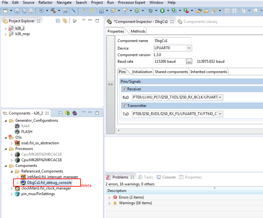

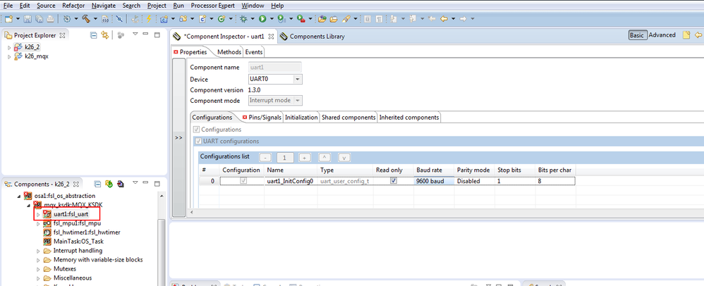

Hello ,
Do you meaning after you add the SPI component , when build , it have  error ?
After you add component ,please configure it until there is no error on the component inspector,
then click the generate code button :
pastedImage_0.png, then build the project.
I also test on KDS3.1 + KSDK1.3, add SPI , then configure it to DMA, there is no error,  please see the attchment .
Below is the steps i create the project :
configure the UART refer to your requirement :
after change to DMA mode , please configure the fsl_edma :

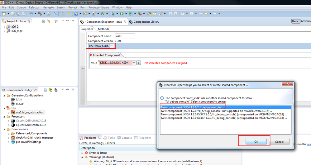

Hello Thomas,
Use the KDS3.0 +KSDK1.3, you can use the SDK-MQX for the K26 chip :

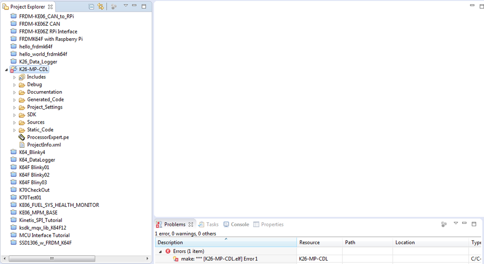

thomasolenik
Hi Alice,
I tried this, but get an error at build time. I am trying to use MQX standard.  Here is a screenshot of the initial error:
Here is the console output:
21:32:38 **** Incremental Build of configuration Debug for project K26-MP-CDL ****
make all
'Building target: K26-MP-CDL.elf'
'Invoking: Cross ARM C++ Linker'
arm-none-eabi-g++ -mcpu=cortex-m4 -mthumb -mfloat-abi=hard -mfpu=fpv4-sp-d16 -O0 -fmessage-length=0 -fsigned-char -ffunction-sections -fdata-sections -Wall  -g3 -T "C:/Users/Tom/workspace.kds/K26-MP-CDL/Project_Settings/Linker_Files/ProcessorExpert.ld" -Xlinker --gc-sections -L"C:/Users/Tom/workspace.kds/K26-MP-CDL/Project_Settings/Linker_Files" -Wl,-Map,"K26-MP-CDL.map" -lgcc -lc -lsupc++ -lm -specs=nosys.specs -nostartfiles -Xlinker -z -Xlinker muldefs -Xlinker -static -o "K26-MP-CDL.elf"  ./Static_Code/System/PE_low_level_init.o  ./Sources/Events.o ./Sources/main.o ./Sources/os_tasks.o ./Sources/rtos_main_task.o  ./SDK/rtos/mqx/mqx_stdlib/source/strings/strings.o  ./SDK/rtos/mqx/mqx_stdlib/source/stdio/buf_prv.o ./SDK/rtos/mqx/mqx_stdlib/source/stdio/err.o ./SDK/rtos/mqx/mqx_stdlib/source/stdio/fclose.o ./SDK/rtos/mqx/mqx_stdlib/source/stdio/fflush.o ./SDK/rtos/mqx/mqx_stdlib/source/stdio/fopen.o ./SDK/rtos/mqx/mqx_stdlib/source/stdio/fp_prv.o ./SDK/rtos/mqx/mqx_stdlib/source/stdio/fread.o ./SDK/rtos/mqx/mqx_stdlib/source/stdio/fwrite.o ./SDK/rtos/mqx/mqx_stdlib/source/stdio/get.o ./SDK/rtos/mqx/mqx_stdlib/source/stdio/pos.o ./SDK/rtos/mqx/mqx_stdlib/source/stdio/print.o ./SDK/rtos/mqx/mqx_stdlib/source/stdio/print_prv.o ./SDK/rtos/mqx/mqx_stdlib/source/stdio/put.o ./SDK/rtos/mqx/mqx_stdlib/source/stdio/scan.o ./SDK/rtos/mqx/mqx_stdlib/source/stdio/scan_prv.o ./SDK/rtos/mqx/mqx_stdlib/source/stdio/stdio.o  ./SDK/rtos/mqx/mqx/source/string/str_utos.o ./SDK/rtos/mqx/mqx/source/string/strnlen.o  ./SDK/rtos/mqx/mqx/source/psp/cortex_m/core/M4/boot.o ./SDK/rtos/mqx/mqx/source/psp/cortex_m/core/M4/dispatch.o ./SDK/rtos/mqx/mqx/source/psp/cortex_m/core/M4/support.o  ./SDK/rtos/mqx/mqx/source/psp/cortex_m/compiler/gcc_arm/comp.o  ./SDK/rtos/mqx/mqx/source/psp/cortex_m/cortex.o ./SDK/rtos/mqx/mqx/source/psp/cortex_m/int_gkis.o ./SDK/rtos/mqx/mqx/source/psp/cortex_m/int_kisr.o ./SDK/rtos/mqx/mqx/source/psp/cortex_m/int_pvta.o ./SDK/rtos/mqx/mqx/source/psp/cortex_m/int_unx.o ./SDK/rtos/mqx/mqx/source/psp/cortex_m/int_vtab.o ./SDK/rtos/mqx/mqx/source/psp/cortex_m/int_xcpt.o ./SDK/rtos/mqx/mqx/source/psp/cortex_m/ipsum.o ./SDK/rtos/mqx/mqx/source/psp/cortex_m/mem_copy.o ./SDK/rtos/mqx/mqx/source/psp/cortex_m/mem_zero.o ./SDK/rtos/mqx/mqx/source/psp/cortex_m/nvic.o ./SDK/rtos/mqx/mqx/source/psp/cortex_m/psp_dati.o ./SDK/rtos/mqx/mqx/source/psp/cortex_m/psp_gelms.o ./SDK/rtos/mqx/mqx/source/psp/cortex_m/psp_hoti.o ./SDK/rtos/mqx/mqx/source/psp/cortex_m/psp_iinit.o ./SDK/rtos/mqx/mqx/source/psp/cortex_m/psp_mat1.o ./SDK/rtos/mqx/mqx/source/psp/cortex_m/psp_mat2.o ./SDK/rtos/mqx/mqx/source/psp/cortex_m/psp_mat3.o ./SDK/rtos/mqx/mqx/source/psp/cortex_m/psp_miti.o ./SDK/rtos/mqx/mqx/source/psp/cortex_m/psp_msti.o ./SDK/rtos/mqx/mqx/source/psp/cortex_m/psp_mstiq.o ./SDK/rtos/mqx/mqx/source/psp/cortex_m/psp_nsti.o ./SDK/rtos/mqx/mqx/source/psp/cortex_m/psp_psti.o ./SDK/rtos/mqx/mqx/source/psp/cortex_m/psp_seti.o ./SDK/rtos/mqx/mqx/source/psp/cortex_m/psp_supp.o ./SDK/rtos/mqx/mqx/source/psp/cortex_m/psp_tiad.o ./SDK/rtos/mqx/mqx/source/psp/cortex_m/psp_tida.o ./SDK/rtos/mqx/mqx/source/psp/cortex_m/psp_tihr.o ./SDK/rtos/mqx/mqx/source/psp/cortex_m/psp_timn.o ./SDK/rtos/mqx/mqx/source/psp/cortex_m/psp_tims.o ./SDK/rtos/mqx/mqx/source/psp/cortex_m/psp_tinm.o ./SDK/rtos/mqx/mqx/source/psp/cortex_m/psp_tins.o ./SDK/rtos/mqx/mqx/source/psp/cortex_m/psp_tiol.o ./SDK/rtos/mqx/mqx/source/psp/cortex_m/psp_tipr.o ./SDK/rtos/mqx/mqx/source/psp/cortex_m/psp_tips.o ./SDK/rtos/mqx/mqx/source/psp/cortex_m/psp_tise.o ./SDK/rtos/mqx/mqx/source/psp/cortex_m/psp_tisu.o ./SDK/rtos/mqx/mqx/source/psp/cortex_m/psp_tius.o ./SDK/rtos/mqx/mqx/source/psp/cortex_m/psp_tkti.o ./SDK/rtos/mqx/mqx/source/psp/cortex_m/psp_usti.o ./SDK/rtos/mqx/mqx/source/psp/cortex_m/sc_irdyq.o ./SDK/rtos/mqx/mqx/source/psp/cortex_m/stack_bu.o ./SDK/rtos/mqx/mqx/source/psp/cortex_m/stack_de.o ./SDK/rtos/mqx/mqx/source/psp/cortex_m/stack_st.o  ./SDK/rtos/mqx/mqx/source/nio/src/errno.o ./SDK/rtos/mqx/mqx/source/nio/src/nio.o ./SDK/rtos/mqx/mqx/source/nio/src/nio_posix.o ./SDK/rtos/mqx/mqx/source/nio/src/nio_std_adpt.o  ./SDK/rtos/mqx/mqx/source/nio/fs/fs_supp.o  ./SDK/rtos/mqx/mqx/source/nio/drivers/nio_tty/src/nio_tty.o  ./SDK/rtos/mqx/mqx/source/nio/drivers/nio_serial/src/nio_serial.o  ./SDK/rtos/mqx/mqx/source/nio/drivers/nio_dummy/src/nio_dummy.o  ./SDK/rtos/mqx/mqx/source/kernel/event.o ./SDK/rtos/mqx/mqx/source/kernel/idletask.o ./SDK/rtos/mqx/mqx/source/kernel/inittask.o ./SDK/rtos/mqx/mqx/source/kernel/int.o ./SDK/rtos/mqx/mqx/source/kernel/klog.o ./SDK/rtos/mqx/mqx/source/kernel/log.o ./SDK/rtos/mqx/mqx/source/kernel/lwevent.o ./SDK/rtos/mqx/mqx/source/kernel/lwlog.o ./SDK/rtos/mqx/mqx/source/kernel/lwmem.o ./SDK/rtos/mqx/mqx/source/kernel/lwmsgq.o ./SDK/rtos/mqx/mqx/source/kernel/lwsem.o ./SDK/rtos/mqx/mqx/source/kernel/lwtimer.o ./SDK/rtos/mqx/mqx/source/kernel/mem.o ./SDK/rtos/mqx/mqx/source/kernel/mqx.o ./SDK/rtos/mqx/mqx/source/kernel/msg.o ./SDK/rtos/mqx/mqx/source/kernel/msgpool.o ./SDK/rtos/mqx/mqx/source/kernel/msgq.o ./SDK/rtos/mqx/mqx/source/kernel/mutex.o ./SDK/rtos/mqx/mqx/source/kernel/name.o ./SDK/rtos/mqx/mqx/source/kernel/partition.o ./SDK/rtos/mqx/mqx/source/kernel/queue.o ./SDK/rtos/mqx/mqx/source/kernel/sched.o ./SDK/rtos/mqx/mqx/source/kernel/sem.o ./SDK/rtos/mqx/mqx/source/kernel/task.o ./SDK/rtos/mqx/mqx/source/kernel/taskq.o ./SDK/rtos/mqx/mqx/source/kernel/time.o ./SDK/rtos/mqx/mqx/source/kernel/timer.o ./SDK/rtos/mqx/mqx/source/kernel/tlsf.o ./SDK/rtos/mqx/mqx/source/kernel/tlsf_adaptation.o ./SDK/rtos/mqx/mqx/source/kernel/watchdog.o  ./SDK/rtos/mqx/mqx/source/bsp/init_bsp.o  ./SDK/platform/utilities/src/fsl_debug_console.o ./SDK/platform/utilities/src/fsl_misc_utilities.o ./SDK/platform/utilities/src/print_scan.o  ./SDK/platform/system/src/interrupt/fsl_interrupt_manager.o  ./SDK/platform/system/src/hwtimer/fsl_hwtimer.o ./SDK/platform/system/src/hwtimer/fsl_hwtimer_systick.o  ./SDK/platform/system/src/clock/MK26F18/fsl_clock_MK26F18.o  ./SDK/platform/system/src/clock/fsl_clock_manager.o ./SDK/platform/system/src/clock/fsl_clock_manager_common.o  ./SDK/platform/osa/src/fsl_os_abstraction_mqx.o  ./SDK/platform/hal/src/uart/fsl_uart_hal.o  ./SDK/platform/hal/src/sim/MK26F18/fsl_sim_hal_MK26F18.o  ./SDK/platform/hal/src/sdhc/fsl_sdhc_hal.o  ./SDK/platform/hal/src/rtc/fsl_rtc_hal.o  ./SDK/platform/hal/src/port/fsl_port_hal.o  ./SDK/platform/hal/src/osc/fsl_osc_hal.o  ./SDK/platform/hal/src/mpu/fsl_mpu_hal.o  ./SDK/platform/hal/src/mcg/fsl_mcg_hal.o ./SDK/platform/hal/src/mcg/fsl_mcg_hal_modes.o  ./SDK/platform/hal/src/lpuart/fsl_lpuart_hal.o  ./SDK/platform/hal/src/gpio/fsl_gpio_hal.o  ./SDK/platform/hal/src/flexcan/fsl_flexcan_hal.o  ./SDK/platform/hal/src/flexbus/fsl_flexbus_hal.o  ./SDK/platform/hal/src/edma/fsl_edma_hal.o  ./SDK/platform/hal/src/dspi/fsl_dspi_hal.o  ./SDK/platform/hal/src/dmamux/fsl_dmamux_hal.o  ./SDK/platform/drivers/src/uart/fsl_uart_common.o ./SDK/platform/drivers/src/uart/fsl_uart_driver.o  ./SDK/platform/drivers/src/sdhc/fsl_sdhc_common.o ./SDK/platform/drivers/src/sdhc/fsl_sdhc_driver.o  ./SDK/platform/drivers/src/rtc/fsl_rtc_common.o  ./SDK/platform/drivers/src/mpu/fsl_mpu_common.o ./SDK/platform/drivers/src/mpu/fsl_mpu_driver.o  ./SDK/platform/drivers/src/lpuart/fsl_lpuart_common.o ./SDK/platform/drivers/src/lpuart/fsl_lpuart_driver.o  ./SDK/platform/drivers/src/gpio/fsl_gpio_common.o ./SDK/platform/drivers/src/gpio/fsl_gpio_driver.o  ./SDK/platform/drivers/src/flexcan/fsl_flexcan_common.o ./SDK/platform/drivers/src/flexcan/fsl_flexcan_driver.o  ./SDK/platform/drivers/src/edma/fsl_edma_common.o ./SDK/platform/drivers/src/edma/fsl_edma_driver.o  ./SDK/platform/drivers/src/dspi/fsl_dspi_common.o ./SDK/platform/drivers/src/dspi/fsl_dspi_edma_master_driver.o ./SDK/platform/drivers/src/dspi/fsl_dspi_edma_shared_function.o ./SDK/platform/drivers/src/dspi/fsl_dspi_edma_slave_driver.o  ./SDK/platform/devices/MK26F18/startup/gcc/startup_MK26F18.o  ./SDK/platform/devices/MK26F18/startup/system_MK26F18.o  ./SDK/platform/devices/startup.o  ./SDK/platform/composite/src/sdcard/fsl_sdhc_card.o  ./Generated_Code/BIT.o ./Generated_Code/Coms.o ./Generated_Code/Control.o ./Generated_Code/Cpu.o ./Generated_Code/DRV.o ./Generated_Code/GPIO_SPI.o ./Generated_Code/Init.o ./Generated_Code/Log.o ./Generated_Code/MainTask.o ./Generated_Code/Sense.o ./Generated_Code/TEMP_SPI.o ./Generated_Code/clockMan1.o ./Generated_Code/dmaController1.o ./Generated_Code/flexCAN0.o ./Generated_Code/flexCAN1.o ./Generated_Code/fsl_hwtimer1.o ./Generated_Code/fsl_mpu1.o ./Generated_Code/fsl_sdhc1.o ./Generated_Code/hardware_init.o ./Generated_Code/memoryCard1.o ./Generated_Code/mqx_ksdk.o ./Generated_Code/osa1.o ./Generated_Code/pin_mux.o ./Generated_Code/uart1.o
arm-none-eabi-g++: error: ./Geneated_Code/Cpu.o: No such file or directory
make: *** [K26-MP-CDL.elf] Error 1
21:33:00 Build Finished (took 22s.7ms)
I then right clicked on the project and ran code analysis. It found a lot of errors as shown below. Any ideas what might be happening?

markkurönö
I seems to me you are hitting the 8192 character limit for the command line length. See this at the very end of your console output:
Thomas Olenik kirjoitti:
Note "Geneated_Code" instead of "Generated_Code".
This thread has a solution for the issue:
https://community.freescale.com/message/515245#515245

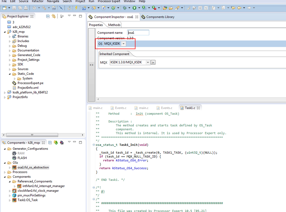

Hello Thomas,
Have you add DMA component ?  While on my side , even though i add this component ,
it also can work well .
Which version of KDS do you use? Please use the latest one kDS3.0 and KSDK1.3 .
I attach my simple project , please test it on your side . You can also send you project to me , i test it
on my side . If your project can work well on my side , it maybe some update you have not install , then
we check which one .

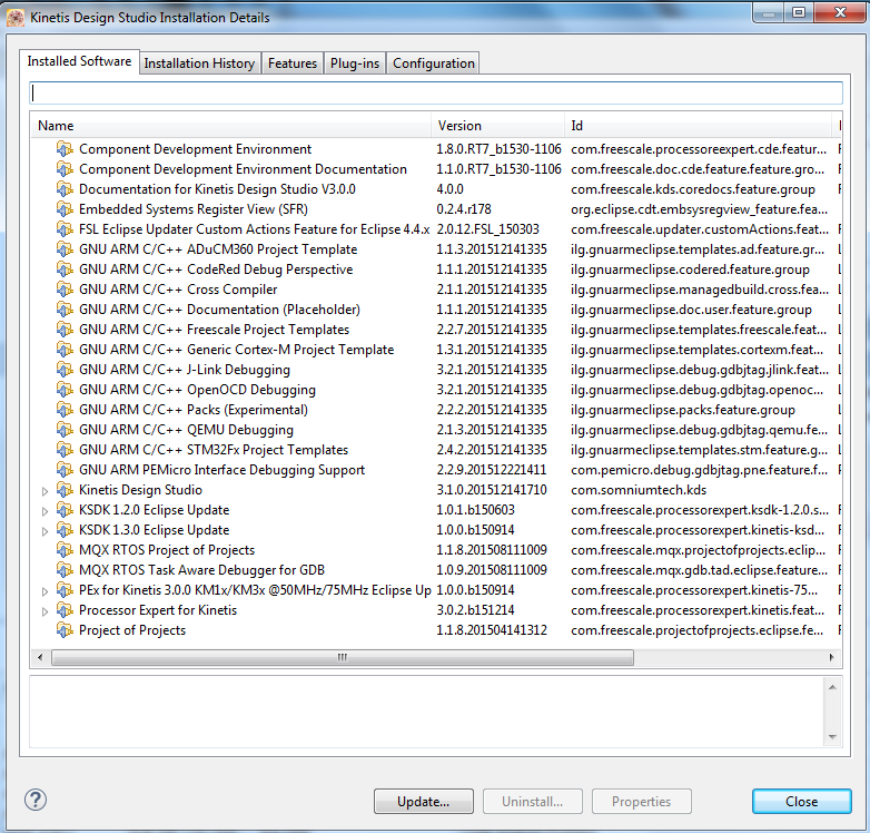

Thanks again for the quick reply. I am using KDS 3.1.0 and checked for updates just a few days ago. I'm now using KSDK 1.3 as well. Here is a full list of my installation details:

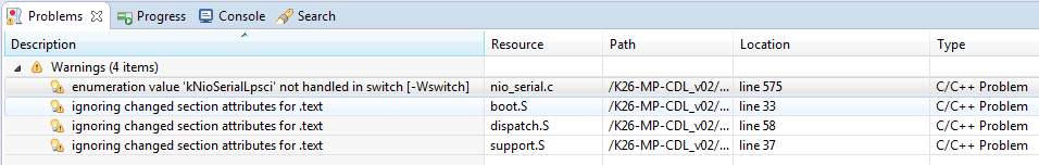

I do not see an attachment to your post, but I created another simple project on my own to test the theory. The simple project built correctly, but with a few warnings as shown:
Except for the essentials for an MQX project, I only added a single OS Task component prior to creating the PE code.

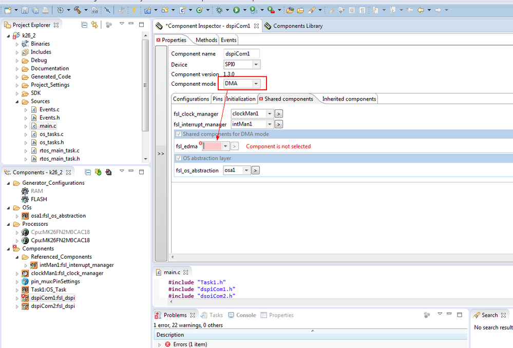

In regards to the DMA question, I have an fsl_dspi component with DMA mode enabled as shown below. I actually have two fsl_dspi components. One is using SPI0 and one is using SPI2.

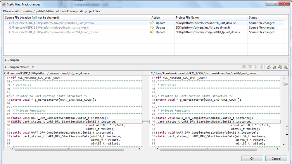

Thank you again. In this particular project, it doesn't seem to matter what components I have. There are not problems shown in the component inspector. I was able to successfully create and build another project, and was able to successfully build the project you provided. So, while I'm not sure why this project will not build, I think I am able to proceed with a new project. One thing I did notice when importing the project you provided is the uart source files are different from what are in the SDK, See below. The project still built correctly.
