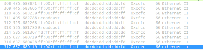

I have added bind to my code before connect function. But the result is same connection time out. I disabled firewall changed ethernet cable. Nothing helped.
In wireshark I can see messages like these... But does't seem familiar.

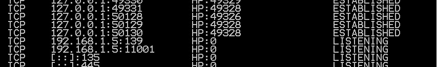

I have verified that my port 11001 on PC is listenning.
When I try ping I receive:Reply from 192.168.1.5: Destination host is unrechable.  or time out...
Any other ideas? Some HW problem? My PC does not respond?
I really appreciate your time.
