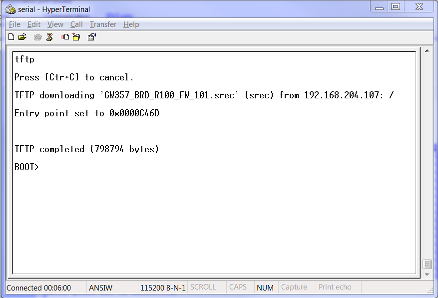

Hi guys,
I am using the FNET 1.0 bootloader to download the file for K60N512 via tftp.
I followed the steps mentioned in the AN4367. I am able to download the file correctly as shown by the log screen.
but when i enter command go and reboot the controller keep getting interrupted and default_irs 3 gets called continuosly. Has anyone seen something like this before:
Thanks in advance
Nikhil

Hi Nikhil,
That ISR tells me that the project has an incorrect entry point... when the bootloader passes control to the application it does not start at the correct address. I had the same experience when developing MQX applications with AN4367. By the way, I was using IAR development environment. Here is my findings, and fixes....
Ethernet Bootloader MQX example
An MQX project needs to have user_config,h modified so that it uses RAM vectors... FNET is using the default vector table at 0x0000_0000.
In user_config.h for the BSP, make the following additions:
#DEFINE MQX_ROM_VECTORS 0
Build the libs.
Take an existing MQX example program. It needs some modifications.
1) Needs a new linker file - see intflash_fnet.icf in the project
2) Entry point needs to be fixed: MQX begins execution in cortex.boot.s at the symbol __boot, which is a public symbol. In IAR project options [Alt-F7] Linker | Library view, Override default program entry and specify symbol __boot
3) Not essential, but in IAR project options [Alt-F7] Output Converter | Output view, give the output SREC a helpful name, eg <projectname>_fnet.srec
Build the project. You can modify the BUILD #define to program varying delays into the LED blinking to test you've actually changed the image.

Hello Mark,
That fix did work like charm, Although I did not do the modification 2, but setting the correct entry point in the intflash.icf file as per the attached linker file did fix my issue. Probably we need to include the example linker file that you attached into the AN4367. Anyways  I will try doing the modification 2 sometime later to see what good/bad effects it has sometime later.
Thanks for the help.
