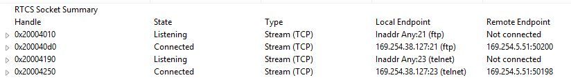

I've tried implementing your suggested changes and it does not seem to have effected the problem.
I've included my socket summary below for both the lockup condition and under normal operation (with FTP and Telnet both connected).
Lockup condition:
Normal operation:
When I see the lockup on FTP and UDP there seems to be a few sockets in the "Ground" state that are not present normally. I have the maximum number of TCP connections limited to 7 for those pictures and if I increase that number I get more "Ground" sockets under the lockup condition.

Kyle, did you check how the listening socket on port 3015 is created ? In normal you show just FTP and TELNET ports open, what is the 3rd one listening on port 3015, in lockup situation ?

kcameron
Hi Martin,
I think I have found where the extra listen socket comes from - it's the FTP server creating a passive data socket in the FTPd_open_passive_data_connection() function in ftpd_cmd.c. When it does this it creates a listen socket, and then calls accept() on that.
Noticing that accept() gets called from there I thought maybe there might be an orphaned "Ground" socket being created there sometimes, too. To test this I copied 85 files of varying sizes on and off of the server - sure enough this seems to be creating problems, too. After a little while and when the wireless signal fades out I can cause a build up of "Ground" sockets this way on top of the situation I described above when I rapidly connect/disconnect a client and fade the Wi-Fi signal.
Once you've answered my pending questions above I'd be very appreciative if you could give this some thought.
9,592 Views
Martin_
Hi Kyle, I looked into the FTPd source code and it looks to me that the data socket, that is created by FTPd_open_passive_data_connection() is shutdown only when the client issues another command, such as "list" ? If you have sequence of "pasv" and "list" then all is fine. What happens with the socket if "pasv" creates it but then link goes down so there is no more "list".  The server should drop idle/inactive connections after some timeout, because I guess by default inactive TCP connections stay alive forever.
So perhaps there should be an application timeout added for this socket, if client does not issue any data command after it has issued "pasv" the app.should shutdown the data socket.
Also, to get rid of the ground sockets, use the approach with RTCS_selectset(). The function that creates ground TCB is the accept() function. So if you do listen() followed by RTCS_selectset() followed by accept() you will have no ground TCBs. Because RTC_selectset would return only after a connection is pending. Do this for all listen sockets in FTPd server.

As for your suggestion to get rid of the "Ground" sockets, unfortunately RTCS_selectset() doesn't work in this case. The problem is that once any command following a PASV command is received it is expected that the server will initiate opening the data socket and start sending data. If I call RTCS_selectset() I never get any activity (data or connection requests) on the listening socket created in FTPd_open_passive_data_connection() from the client side, so the FTP server fails to open the data socket and gives up.
I've also found another problem that is much more severe:
If I fade out Wi-Fi after a command such as LIST has been received but just before accept() is called, then accept() never returns and my FTP server locks up completely - if I put break points in FTPd_task() or FTPd_child() the code is not running at all.
To fix all of the problems I am now seeing, I need to find some method, other than RTCS_selectset(), to cause accept() to return. I see two methods to trigger this - I can either detect from the Wi-Fi driver that the link has been broken, or I can add a timeout. The problem is I'm having a hard time trying to figure out where in the TCP stack I can actually cause accept() to return? Any suggestions?
Martin_

Hi Martin,
Never mind about the  RTCS_selectset() not working. It turns out I just needed to setup a for loop and call it repeatedly for awhile in order to detect activity on the data socket, as follows. This fixes my problem where the FTP server locks up AND where I get a build up of "Ground" sockets while copying a large number of files and fading out the Wi-Fi signal.
// Try to detect activity on the listening socket every 100mS for up to 5 seconds

I've also modified the code in FTPd_task() as follows. This fixes the first problem I was seeing where the build up of "Ground" sockets happens when I connect/disconnect from the FTP rapidly and fade Wi-Fi out. The changes from my last post of this code are:
  1. Line 129: I've added a check to see if RTCS_selectset() returned 0 or the socket handle - this prevents accept() from being called unnecessarily.
  2. Line 231: I've added to the else() statement a shutdown() of the childsock if accept() fails. This appears to be all I need to be for my needs in order to prevent "Ground" sockets from building up.

Line 231, execution arrives there if childsock is either zero or RTCS_SOCKET_ERROR, because it is else for line 134. So this code on line 231 effectively does nothing, because inside shutdown() there is an error check to return if given sock is zero or RTCS_SOCKET_ERROR.
Perhaps you can remove the line 231 and hopefully all works still well.
-Martin

We've made a little more progress by adding some diagnostics to the TCP code. When we iterate through the list of active TCB's we find that there are a number of blocks that appear to be stuck in the "CLOSE_WAIT" state under the failure condition.
9,592 Views
Martin_
so, TCBs in CLOSE_WAIT state might mean that your application does not call shutdown() to a connected socket in response to received FIN.
maybe you could add a debug condition to see if this is happening. for example, to SOCK_STREAM_shutdown() function, add a counter that increments with each shutdown request. And then add another counter to count incoming FIN: into TCP4_Service_packet, something like: if(flags & FIN) {g_fincnt++;}
then when the lockup situation occurs, check if these two counters match or not. if they not matched, it would mean the application does not call shutdown() when remote peer sends FIN.
9,592 Views

I think your probably right that the shutdown() is not called. When the Wi-Fi connection fades out, though, we will likely never receive a FIN.
I've implemented counters in both SOCK_STREAM_shutdown() and TCP4_Service_packet() and monitored their values. The counter in TCP4_Service_packet is always zero, which I think means this function is never called. We definitely are using IPV4.
I've snooped around some more and I've got a theory about what's going on:
In ftpd.c under the FTPd_task() function, a listening socket is created, setup and bound to listen for FTP connection requests. After this is done the code enters an infinite loop that calls accept() to create a new socket for the FTP connection when it is requested by a client. Drilling down into what happens when accept() is called reveals that the TCB data structures are created, but never bound to an endpoint. This is where the "Ground" state comes from - "Ground" state appears to be the guts of a socket that is setup and waiting to be connected to an endpoint.
Now, after looking around in these forums, I've found the following post:
Re: FTP socket problem
This person appears to have had a similar problem. They found that these sockets in the "Ground" state are created by the accept() function, and if FTPd_stop() is called before accept() returns the listening socket is released, however, the "Ground" socket, hanging in limbo waiting for a connection, is not.
Could this be what is happening when the Wi-Fi signal fades out? An FTP connection with a client is started, but then part of the way through (before accept() returns) the connection fades out, which causes a timeout that closes the listening socket and not the "Ground" socket? How could I fix this? I've tried calling TCB_Close_TCB() followed by TCP_Process_release() on the sockets stuck in CLOSE_WAIT but it doesn't seem to have any effect.

When a connection timeout occurs due to lost link, the TCP/IP task will close the TCB for that connection, and socket layer will receive an error. So a recv() or send() will get an error. Now, perhaps your FTP client tries to open a new connection, so it sends a new SYN ? Is the ftp client configured to automatically reconnect or something like that ? Because accept() creates the ground socket, that is right, but it will create just one per connection. So if you have more ground sockets, it might mean the ftp client tried to open more connections when the link is bad.
By the way, the only place in the code where a TCB goes into CLOSE_WAIT state is in the TCP_Process() function, when TCB is in SYN_RECEIVED or ESTABLISHED state and FIN is received (if ( (flags & FIN) != 0 ) {). So I guess the TCBs in CLOSE_WAIT state have received FIN.
When you mention FTPd_stop(), do you call this function ? If so, please do not use it. MQX function _task_abort() is very dangerous, because what it does it sets the program counter to exit handler without any synchronization with the task being aborted. If the task calls some MQX or RTCS API functions, you never know what it executes when _task_abort() is called. For example it can have a semaphore locked, or a message sent to TCP/IP task, waiting for response, then you abort the task, but the semaphore or TCP/IP task doesn't know and everything is wrong since then .....
In our latest applications, we strictly don't use _task_abort(). When we need to stop a service like FTP, we basically use a synchronization mechanism to let the task destroy itself gracefully (by return from the task body). You can look to FTPSRV or HTTPSRV in our latest MQX - we shutdown() the listening socket. We have a select() function waiting on activity on the listening socket, when it is closed, select returns error and we gracefully free all resources, post semaphores etc, destroy all child tasks etc.
So, you should not use FTPd_stop(). If you need to release the FTP server, I suggest this way: just call shutdown on listening socket, and change the for(;;) loop in FTPd_task to handle this request.
Now, please be aware there is one more bug: when you shutdown() listening socket, the accept() function will not return. We have fixed this bug for next MQX release. But for you, there exists a workaround to this bug that works. The workaround is to use RTCS_selectset() function before accept(), like this:
my_sock_set[0] = listensock;
sock = RTCS_selectset(...my_sock_set....);
childsock = accept(sock, ....);
if the socket has been shutdown, the accept() after RTCS_selectset() will return RTCS_SOCKET_ERROR. Then in the FTPd_task, release all memory that it has allocated, shutdown all sockets it has created and return from task body.
These issues are one of the reason why we migrated the FTP to new FTPSRV application. The new FTPSRV solves all these FTP service release issues, supports IPv6 and allows multiple file transfers in parallel.
9,592 Views

   // RTCS maintains the connection for this number of milliseconds. Must be minimum of 180,000
   if (!error)
      option = FTPDCFG_CONNECT_TIMEOUT;
      error = setsockopt(listensock, SOL_TCP, OPT_CONNECT_TIMEOUT, &option, sizeof(option));
   // Two times the maximum segment lifetime (which is a constant). Returned information is for the last
   // frame that the socket received.
   if (!error)
      option = FTPDCFG_TIMEWAIT_TIMEOUT;
      error = setsockopt(listensock, SOL_TCP, OPT_TIMEWAIT_TIMEOUT, &option, sizeof(option));
   // fixme cwp - added to see if we can fix ftp lockup on loss of wifi
   if (!error)
       option = FTPDCFG_RECEIVE_TIMEOUT;  // Set this value to what you need (360000 for 6 minute, for me)
       error = setsockopt(listensock, SOL_TCP, OPT_RECEIVE_TIMEOUT, &option, sizeof(option));
   if (!error)
       option = FTPDCFG_NO_NAGLE_ALGORITHM;
       error = setsockopt(listensock, SOL_TCP, OPT_NO_NAGLE_ALGORITHM, &option, sizeof(option));
   if (!error)
      error = bind(listensock, (const sockaddr *)&laddr, sizeof(laddr));
   if (!error)
      error = listen(listensock, 0);
   if (error)
      RTCS_task_exit(creator, error);
   RTCS_task_resume_creator(creator, RTCS_OK);
   for (;;)
      // Connection requested; accept it
      remote_addr_len = sizeof(remote_addr);
      watchdog_set_state_blocking(ftpd_task_index);
      // KDC: Added this at the suggestion of Freescale. This will causes accept() to return RTCS_SOCKET_ERROR if the listening socket has been shutdown
      sock = RTCS_selectset(&listensock, 1, 10000/*FTPDCFG_CONNECT_TIMEOUT*/);
      // KDC: end of above
      childsock = accept(sock,(sockaddr *)&remote_addr, &remote_addr_len);
      watchdog_set_state_active(ftpd_task_index);
      if ((childsock != 0) && (childsock!=RTCS_SOCKET_ERROR))
         session_ptr = (FTPd_SESSION_PTR) RTCS_mem_alloc_zero(sizeof (FTPd_SESSION_STRUCT));
         if ( session_ptr )
            _mem_set_type(session_ptr, MEM_TYPE_FTPd_SESSION_PTR);
            session_ptr->DATA_BUFFER_SIZE = FTPDCFG_BUFFER_SIZE; // KDC: Changed this
            session_ptr->DATA_BUFFER_PTR = RTCS_mem_alloc_zero(session_ptr->DATA_BUFFER_SIZE);
            if (session_ptr->DATA_BUFFER_PTR == NULL)
               _mem_free(session_ptr);
               session_ptr = NULL;
            else
               _mem_set_type(session_ptr->DATA_BUFFER_PTR, MEM_TYPE_FTPd_DATA_BUFFER);
         if (session_ptr == NULL)
            shutdown((uint_32)childsock, FTPDCFG_SHUTDOWN_OPTION);
         else
            session_ptr->CONTROL_SOCK = (uint_32) childsock;
            session_ptr->CONNECTED = TRUE;
            /* set default data ports */
            session_ptr->SERVER_DATA_SOCKADDR.sin_family      = AF_INET;
            session_ptr->SERVER_DATA_SOCKADDR.sin_port        = IPPORT_FTPDATA;
            session_ptr->SERVER_DATA_SOCKADDR.sin_addr.s_addr = INADDR_ANY;
            session_ptr->USER_DATA_SOCKADDR.sin_family      = remote_addr.sin_family;
            session_ptr->USER_DATA_SOCKADDR.sin_port        = remote_addr.sin_port;
            session_ptr->USER_DATA_SOCKADDR.sin_addr.s_addr = remote_addr.sin_addr.s_addr;
#if FTPDCFG_USES_MFS
            //initialize current directory and current filesystem
            devlen = _io_get_dev_for_path(session_ptr->CURRENT_FS_NAME, &dev_in_path, FTPD_DEVLEN,(char *)FTPd_rootdir, NULL);
            session_ptr->CURRENT_FS = _io_get_fs_by_name(session_ptr->CURRENT_FS_NAME);
            error = ioctl(session_ptr->CURRENT_FS, IO_IOCTL_CHECK_DIR_EXIST,(pointer)FTPd_rootdir );
            if (error)
#endif
               session_ptr->CURRENT_FS = NULL;
               session_ptr->CURRENT_FTP_DIR = NULL;
               session_ptr->CURRENT_FS_DIR[0] = '\0';
            else
               // set current fs dir (including root dir)
               strcpy(session_ptr->CURRENT_FS_DIR,FTPd_rootdir+devlen);
               rootdirlen = strlen(session_ptr->CURRENT_FS_DIR);
               // set current FTP dir
               session_ptr->CURRENT_FTP_DIR = session_ptr->CURRENT_FS_DIR + rootdirlen - 1;
               //check if there is / at the end of root dir name
               if(*(session_ptr->CURRENT_FTP_DIR) != '\\' && *(session_ptr->CURRENT_FTP_DIR) != '/')
                  session_ptr->CURRENT_FTP_DIR++;
               session_ptr->CURRENT_FTP_DIR[0] = '\\';
               session_ptr->CURRENT_FTP_DIR[1] = '\0';
#endif
            #if FTPDCFG_ENABLE_MULTIPLE_CLIENTS
               /* Create a task to look after it */
               RTCS_detachsock(childsock);
               t_ptr = _task_get_template_ptr(MQX_NULL_TASK_ID);
               if (RTCS_task_create("FTPd_child", t_ptr->TASK_PRIORITY, t_ptr->TASK_STACKSIZE, FTPd_child, (pointer) session_ptr) != RTCS_OK )
                  RTCS_attachsock(childsock);
                  shutdown(childsock, FLAG_ABORT_CONNECTION);
                  _mem_free(session_ptr->DATA_BUFFER_PTR);
            #else
               FTPd_child((pointer) session_ptr,0);
            #endif
      else
          printf("Failed to create child socket...\n");
          // Not sure what to do here...
9,592 Views
Martin_
It is application dependent. In FTPSRV, we have defined a close request to listening socket as application request to release the server. So we basically free all resources we have allocated, we send messages to all child tasks to destroy themselves, shutdown all sockets we have created etc. FTPSRV can be safely start and released many times.
In you application, if you don't allow to stop the FTPSRV, then I guess a time delay would be sufficient. You never call shutdown on the listening socket, so childsock will be RTCS_SOCKET_ERROR if accept() fails, for example due to low memory resources for the new connection, so maybe after a timeout there will be more memory available in the system, as other tasks finish and free resources.

kcameron
Hi Martin,
Thanks again for your prompt responses - you have no idea how frustrating it is when we're trying to meet deadlines and we have to wait for a long time for responses to help us when we're stuck!
We're not explicitly calling FTPd_stop() in any code that we've written, I just assumed (apparently wrongly) from the posts made in that discussion I referenced that FTPd_stop() gets called somewhere in the TCP code.
Thanks for the explanation of the bug in the for(;;) loop - now we're getting somewhere. I'll try to implement your suggested fix and report back.
9,592 Views
kcameron
One more thing - to answer your question about the client trying to reconnect: yes we have a python script that opens and closes an FTP connection every second or so. We found this allows us to reproduce the failure mode reliably if we use it in conjunction with attenuating the Wi-Fi signal.
