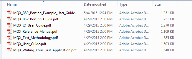

danielchen
Hi Jason:
The MQX documents are under the MQX installation folder,
Freescale_MQX_4_2\doc\
The deference between Release mode and Debug mode, is in Debug mode there will be debug information added into the executable.  And the optimization level is different.
