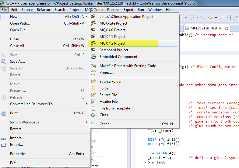

I have some problems to add MQX 4.2 to Codewarrior 10.6. I used the option Install new software, this said me that MQX patch were added successfully; however, when I wanted to create a new MQX 4.2 Project, it was not of my options in File/New. I have tried everything like as reinstalling  codewarrior, and it was the same result.
My Codewarrior is 10.6 Special Edition Offline.

CW10.6 can support MQX4.2 without problem.
please go to IDE menu "help", "install new software" to install related MQX4.2 plugins.
this should enable MQX4.2 from menu:
can it help you?

OK, After repeating three times your instructions; finally, I could install MQX 4.2 Wizard :smileyhappy:
