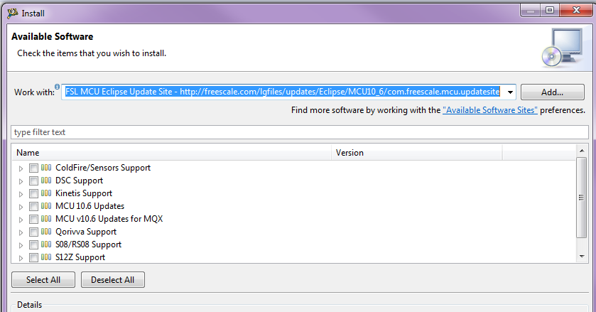

I'm missing the MQX 4.0 project wizard (only MQX-Lite available)! See picture below. How do I get it? Do I need to buy a specific liscense to get this?
System: Windows 7
Installed: CW 10.6, MQX 4.2
anyone who can help me?
best regards, Nik

Hello Niklas,
Please follow the below steps:
1. Go to Help->Install New Software
2. In the work with space select  FSL MCU Eclipse Update Site - http://freescale.com/lgfiles/updates/Eclipse/MCU10_6/com.freescale.mcu.updatesite
3. Select MCU v10.6 Updates for MQX and click next  (follow the steps to complete the operation)
4. After install the plug-ins, restart CodeWarrior. At this point you should be able to create a new MQX project.
Sol

Work just well!! Thank you for your help!! :smileycheck::smileyplus::smileylaugh:
