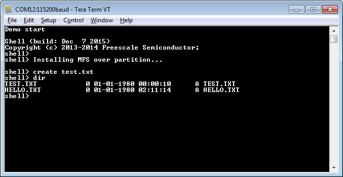

I just installed MFS on an SD card following an example in the SDK.  I am now experimenting with my new FS.  I can mkdir, cd, dir, etc... However, I can not seem to create a new file.
I type 'create test.txt' and the shell just hangs.  Am I doing something wrong?  Or is there something I should check? Do I need to enable 'user mode' somehow?
When I debug, it seems to hang in the lwsem.c code.  I am using a TWRK65F180M.
Thanks for any tips.

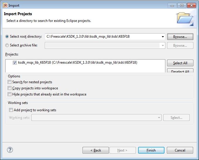

  • Open KDS and select import, then select Existing Projects into Workspace located under General folder and look for KSDK library for MQX in C:\Freescale\KSDK_1.3.0\lib\ksdk_mqx_lib\kds and import the project for K65F18
  • Compile ksdk_mqx_lib_K65F18 project.

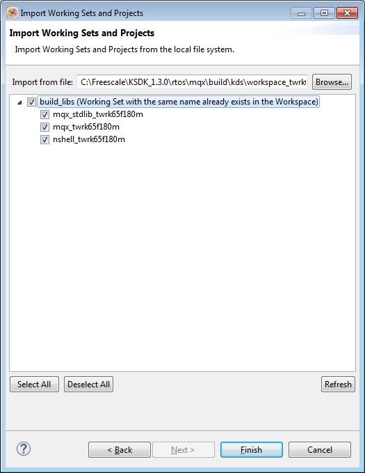

  • Locate MQX working set for TWR-K65F180M in C:\Freescale\KSDK_1.3.0\rtos\mqx\build\kds\workspace_twrk65f180m and select build_libs.wsd:
  • Compile these libraries and no error should be shown.

  • Now, import the sdcard example located at: C:\Freescale\KSDK_1.3.0\middleware\filesystem\mfs\examples\sdcard\build\kds\sdcard_twrk65f180m. Compile this project and download into your TWR board.
  • Run the project and open a terminal at 115200bps and test the shell commands.
I hope this can help you. If there is other doubt please do not hesitate on contact me.
