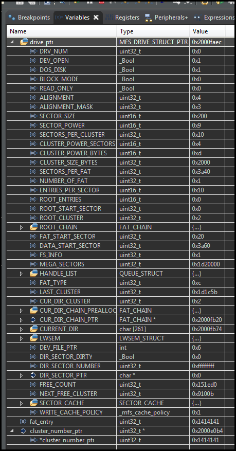

I am using KSDK 1.3.0 with MQX and MFS.  We are using a 16 GB SD Card.
I am evaluating the reliability of the MFS file writes by using 1 task that writes to files.  I was running into issues with timeouts originally (see here).  I have a tick time of 1 ms for my system so I set the timeouts to the following until I hear back from what they should be set to in my other post:
#define ESDHC_CMD_TICK_TIMEOUT 40 // 40ms
#define ESDHC_CMD12_TICK_TIMEOUT 1000 // 1 Sec
#define ESDHC_TRANSFER_TIMEOUT_MS 750 // 750ms
I am still using a similiar test procedure as before:
1. Create a new text file.
2. Write 1 KB of data into the file.
3. After 1024 Writes (1 MB), close the file.
4. Open the same file, seek to the end.
5. Perform steps 2 - 4 until I write 1,000 MB to the file.
6. After 1,000 MB has been written, close the current file and create a new one. Repeat steps 2-4 until 8 files have been created. (We are using a 16 GB card)
The farthest I have gotten is 5 files written before a failure during the writing of the 6th.  The errors I am receiving are the following:
MFS_SECTOR_NOT_FOUND
MFS_INVALID_CLUSTER_NUMBER
These appear to happen at random.  Again, all I am doing in my program is writing to files.
The latest error happened in the function "MFS_get_cluster_from_fat".  I set a breakpoint here so I am able to see the context of variables:
drive_ptr information and fat_entry:
So, fat_entry is a value of 0x0141_4141, but the LAST_CLUSTER is 0x001D_1C5B, so we are trying to write into a cluster that is greater than the max, which is why it fails.
However, I am not sure how fat_entry gets its value.
How did it become greater than the LAST_CLUSTER?

The root cause of this issue is an overflow of a unsigned 32-bit number when trying to access the sector.  It is confusing to follow through the functions because sometimes the LOCATION is referred to by a SECTOR, and sometimes it is referred to by BYTE.
In my SD Card, a sector is 512 bytes. In the function mfs_rw.c a sector location is converted into a byte location.  This is accomplished by multiplying the byte location by the number of bytes in a sector.  This is all done with 32-bit variables.  This variable will overflow when the sector is 0x0080_0000.  When multiplying by 512 the byte location becomes 0x0001_0000_0000.  Since it is a 32-bit value it will be saved as 0x0000_0000 and writing to this location will corrupt the file system.
By the way, a sector location of 0x0080_0000 with 512 bytes per sector corresponds to 4 GB.  When I tested with a 4 GB SD card I never saw the issue.  We will be using 16 GB going forward.
The following changes pass the test I created as described in the original post:

comp.h can be found at \KSDK_1.3.0\rtos\mqx\mqx\source\psp\cortex_m\compiler\iar
3,981 Views
jschepler
EDIT 2018-04-12: nio_error of MFS_FILE_NOT_FOUND was caused by a different call to _nio_open outside of the loop.  I did not correctly reset nio_error to 0 before I started the loop.  The issue I am describing below does not exist.
Update: I am still trying to find the root cause of this issue.  Interestingly, I am writing one character repeatedly to the file, 'A', which happens to be a value of 0x41.  This is the value seen for the cluster number above.
As this error occurred again today, I noticed the error value was 0x3002 (MFS_FILE_NOT_FOUND) before the call to write.
How did this happen? I have a check to make sure the file descriptor is not < 0:
