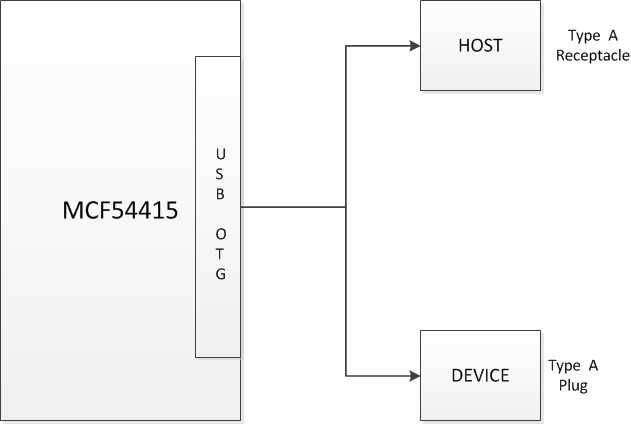

We have a system using MCF54415 and I am intending to use the USB OTG port as Host.
We took the Tower example project for USB Host. But as the Tower board does not use OTG port for USB Host, I need to make some changes.
I made the following changes in twrmcf54418.h :
    1. Commented       // #define USBCFG_USBOTG_CONNECTOR                         USBCFG_CONNECTOR_ULPI.
    2. Added                    #define USBCFG_USBOTG_CONNECTOR                         USBCFG_CONNECTOR_STANDARD
    3. Commented       // #define USBCFG_DEFAULT_HOST_CONTROLLER            (&_bsp_usb_host_ehci1_if)
    4. Added                   #define USBCFG_DEFAULT_HOST_CONTROLLER            (&_bsp_usb_host_ehci0_if)
    5. Commented       // #define USBCFG_EHCI                                                          1
    6. Added                   #define USBCFG_EHCI                                                          0
I have tested it and it is not working (that is why I am here :smileyhappy: ).
So all the brainies out there, please help me fixing the issue. Please let me know what and where more changes are to be made.

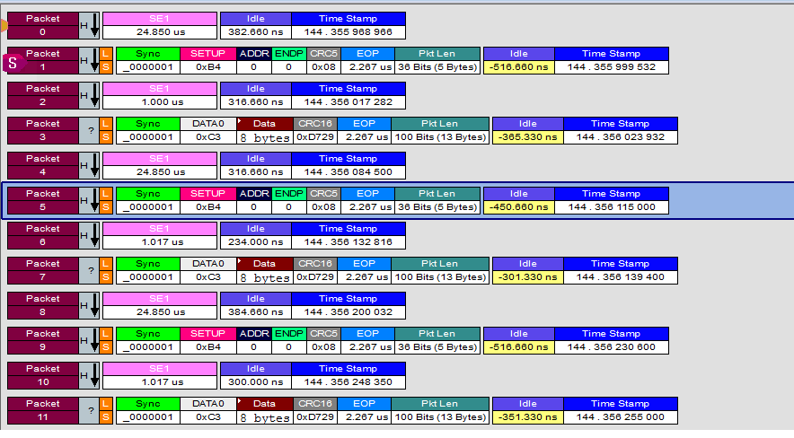

nitinkothari
Hi Garabo,
Sorry but we cannot afford the Level 2 support.
So I am on my own to get this fixed.
In the pursuit, I have succeeded in getting the Host send SETUP packets.
So, as you can see, there is also SE1 condition between two packets.
Can anyone help me now ?

nitinkothari
Hi Garabo,
I appreciate your efforts. It seems that I have fixed the issue and the port is communicating now.
But the MFS is giving me error : MFS_NOT_A_DOS_DISK. Shall I create a new thread for this issue ?

Kan_Li
Hi Nitro,
Just some supplement to Garabo's comment. The MQX's USB stack doesn't support OTG opertaion, but you can use the OTG module on MCF54418 as a dule role USB port. With the following modification, you may get it work as a Host port . I just run the msd command demo on TWR-MCF54418 with TWR-SER2, you may try it as well.
Hope that helps,
Kan
3,763件の閲覧回数
nitinkothari
Hi Kan,
Thanks for your time.
I tried with the changes you had mentioned. But the BSP settings mentioned above are not applicable to my setup, hence it did not work. :smileysad:
In my system, there is no ULPI interfaces. I am trying to use the OTG port directly to act as a host.
Kindly see the diagram of my setup.
Please let me know what else shall I change.
Thank you again.
Nitro
