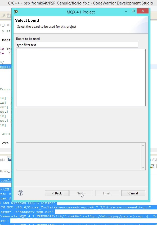

I'm trying to compile my own application using the combination CW 10.6 + MQX RTOS 4.1.0 for FRDM-K64F.
First, I tried to create a project by going to New > MQX 4.1 Project - however, after naming the project, no board appear in the board selection dialog. Is this a bug or am I doing anything wrong? I've tried already to reinstall the RTOS package after CW 10.6 installation.
2014-06-11 17_53_36-C_C   - psp_frdmk64f_PSP_Generic_fio_io_fp.c - CodeWarrior Development Studio.png

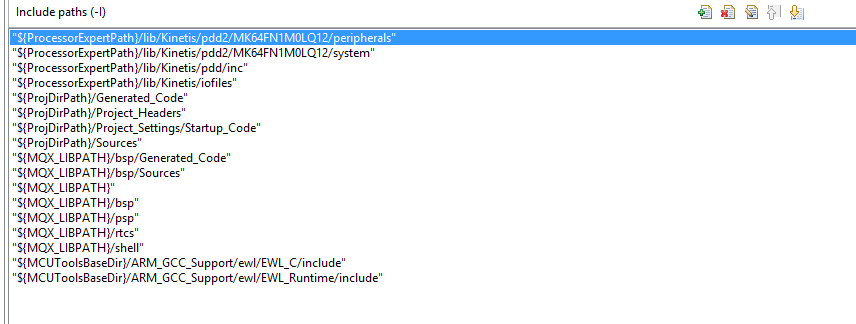

- added on the 'compiler include directories' table all bsp, psp, rtcs and other MQX RTOS directories (as in sample projects, same order)
- added bsp, psp, rtcs and shell libraries to the 'Other objects' table in the Linker settings, as in the sample projects

The weird part is that I checked bsp.a lib and it contains a init_hardware() function available on init_hw.o. If this lib is being pointed as "Other Objects" section of the project linker settings, why can't the linker find the function? I'm sure init_hw.o is on bsp.a lib, which is being included. Below is the prints of my compiled includes and linked "other objects":

OK, I just find out what the problem was with the init_hardware function: the linking order.
There are 2 ways I could get around it:
  • changing link order, putting all static libraries (*.a) in the top of the link order list
  • changing the linker line by putting -Xlinker --start-group ${INPUTS} -Xlinker --end-group, insted of just ${INPUTS} as the default link line. I found out that in the example projects this is already done. It means the linker should check all the objects/libs cyclically until it can get dependencies resolved.

ZhangJennie
hi Luiz,
Yes, the MQX 4.1 New Project Wizard does not contain the support for K64 boards (both FRDM and TWR) so far. We will assign engineer to work on it.
