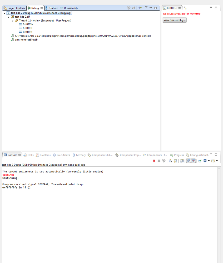

My application compiles and builds......
When i try to debug, It crash and burns.....
Can someone provide some insight?
Setup
KDS 1.1.0
MQX 4.1.1 with PE
PE Micro MultiLink
FRDMK64F
Error Message
The target endianness is set automatically (currently little endian)
continue
Continuing.
Program received signal SIGTRAP, Trace/breakpoint trap.
0xfffffffe in ?? ()

BlackNight
I tried your project, and see the problem, but not sure what it is.
What I can say is that the debug configuration is fine, and the problem seems to be MQX specific.
If I disable MQX, the project runs fine.
4,018 Views

trytohelp
Now I've installed the FSLMQXOS_4_1_1_GA.exe.
I've followed step by step the process explaining in the MQX_KDS_Getting_Started.pdf doc which is located under the installation folder
      \Freescale_MQX_4_1\doc\tools\kds
with frdmk64f instead of twrk64f120m.
After to have built the MQX lib I'm able to build the project without problem.
By default the configuration is for JLink. I've created a new one for P&E.
Now I can launch the debugger and the application is loaded on-board through the Multilink interface without problem.
Is it working on your side ?
May be there is a problem to import an application created under MCU V10.6 to KDS when MQX V4.1.1 is used.
It seems to be your case
