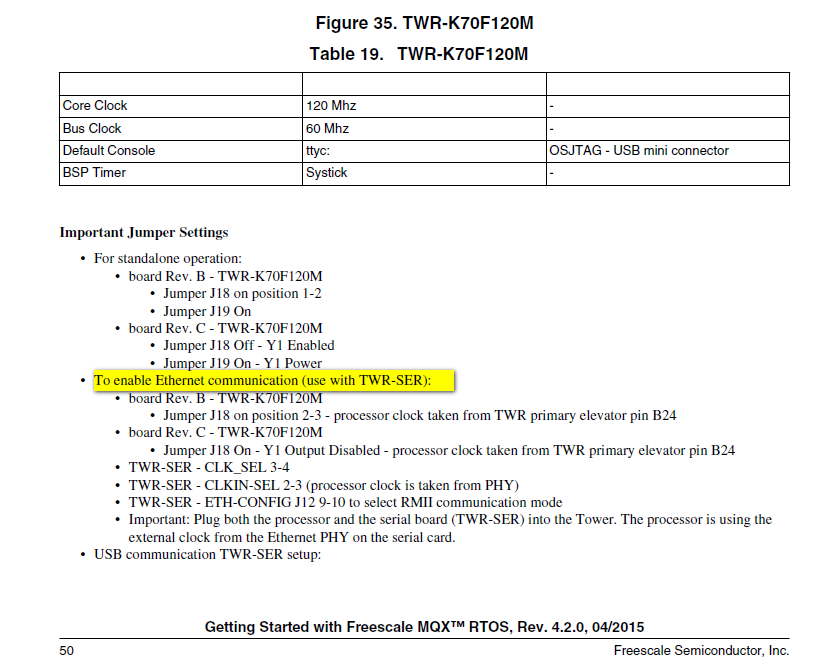

Hi team,
I am having TWR-K70F120M and TWR-SER modules.
TWR-K70F120M  module has SCH-27166 Rev C2
I am working for Ethernet communication (RTCS).
I want to get verified following things.
Jumper connections of TWR-K70F120M.
          J18 is OFF     and J19 is ON.
   Jumper connections of TWR-SER.
                 J2--> 3-4 is ON (pin 3-4 are short),            J12 --> 9-10 is ON,                     J3-->2-3 is ON.
I will use MQX 4.2.
Additionally I will use "eth_to_serial" example given at "C:\Freescale\Freescale_MQX_4_2\rtcs\examples".
Kindly verify the bold items.
Sudhanshu
1 返信
958件の閲覧回数
LuisCasado
Check C:\Freescale\Freescale_MQX_4_2\doc\ MQX_Getting_Started.pdf
Luis
