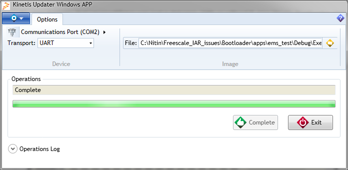

So, now it seems that VersionSTring was just a delusion. With or without it, now Kinetis Bootloader claims it has flashed everything fine but it has NOT.

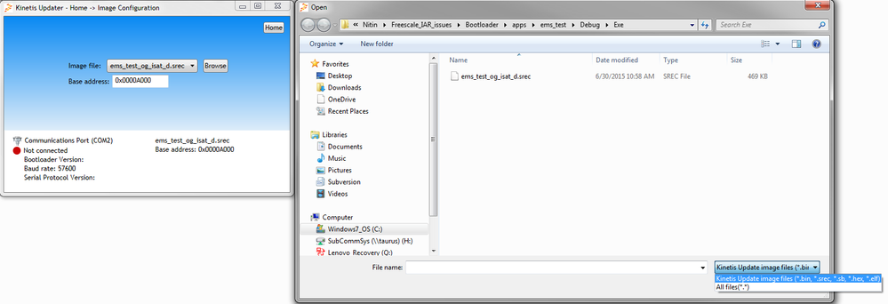

This is snapshot of PC loader APP claiming everything is FINE:
After flashing, my image never starts, so I attached my debugger to see what is going on in processor's head and
I know that my image starts from 0xA000 and look at the memory map:
It seems like PC APP/Bootloader forgot to flash that region but somehow thought it is OK/FINE to do that.
Also, Please find attached our bootloader and app which we are trying to flash.

ericocasio
I was able to reproduce your problem.  After speaking with the developers of the host-side update utility, it appears that even though SREC is available as an option for the file to be downloaded, it's not actually supported in the tool.  Please try generating your application image as a raw binary (BIN) file and try updating it that way.

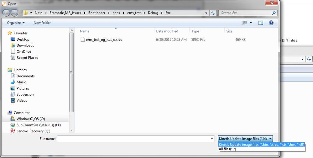

But if SRECs were NOT supported shouldn't they be restricted in the file browse selection window of the PC updater APP ?
Anyway, Had telecon with MQX experts GarySegal DavidS​, and they suggested us with the same thing, try to use BIN files.

ericocasio
Yes, it's a bug.  The file extension filter should not have gone out with SREC as an option.

nitinharish
Contributor V
Surprisingly, even Kinetis Bootloader 1.1.0 (latest release) also has it.
