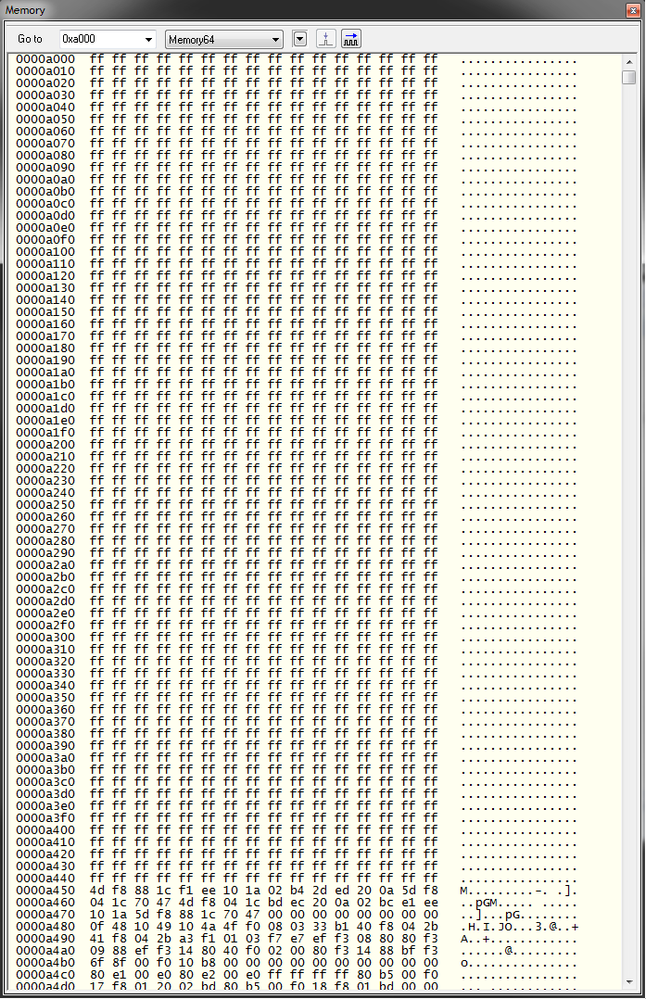

After flashing, my image never starts, so I attached my debugger to see what is going on in processor's head and
I know that my image starts from 0xA000 and look at the memory map:
It seems like PC APP/Bootloader forgot to flash that region but somehow thought it is OK/FINE to do that.

I was able to reproduce your problem.  After speaking with the developers of the host-side update utility, it appears that even though SREC is available as an option for the file to be downloaded, it's not actually supported in the tool.  Please try generating your application image as a raw binary (BIN) file and try updating it that way.

But if SRECs were NOT supported shouldn't they be restricted in the file browse selection window of the PC updater APP ?
Anyway, Had telecon with MQX experts GarySegal DavidS​, and they suggested us with the same thing, try to use BIN files.
