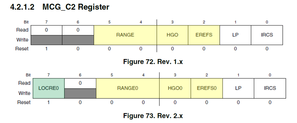

I am trying to update a project running on a Freescale MK10DN512VLQ10 using MQX 3.7 to use MQX 4.2.  I went through the cloning process using twrk60n512 as the base and am running into a lock up situation.  In bsp_cm.c, when we go into __pe_initialize_hardware, things seem to be fine until we hit the line setting MCG_C2.  Since it's the same processor, why is it setting different values for MCG_C2 and MCG_C1 vs. what it was setting in MQX 3.7?

Hi Eric:
There are two bsps for K60 in MQX 4.2, one is K60N512 (Rev 1.x, old version), the other is K60D100M (Rev2.x), the MCG_C2 is different, please see below.
K60D100M features the MK60DN512VMD10, maybe similar to your chip.
I would suggest you use BSP for TWR-K60D100M as the clone base and try it again.

Hi Daniel -
Today I tried doing that, but I see the same kind of failure.  The code is a bit different now, this time the issue comes up when it hits the line setting MCG_C7 and if I put a watch on it, is says it's undefined but I can see things like MCG_C1, MCG_C2, etc. so I suspect that I actually do have a Rev. 1.0.
Going back to the original issue, when we get to the line where we first set MCG_C2 to 0x21, I stepped through the disassembly and saw that the MOVS command successfully writes the 0x21 into R0, and then the LDR.N command successfully writes 0x40064001 (the address of MCG_C2) into R1.  The problem comes with the STRB command which should write the value in R0 into R1.  When I process that step, the disassembly jumps me back to 0x0 and it locks up.   Is that likely because there's some kind of issue with writing that value to that register?

danielchen
what is the mask set of your MCU?  you can get it from the MCU. For example, the mask set of mine K60n512 is 0M33z.
1,790 Views
gopher
There are chips of varying ages in the devices I'm working on - the ones I have for testing have 2N30D, 4N30D or 8N30D.
1,790 Views
danielchen
Yes, the chips you are working are Rev. 1.x.

gopher
I'll keep working on it.  Are mask sets 4N22D and 5N22D both Rev 2.x?
1,790 Views
danielchen
Hi Eric Thrall
Yes,  both are Rev 2.x
