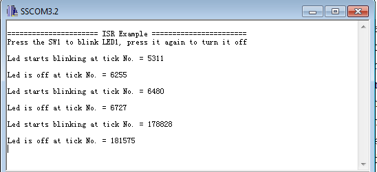

danielchen
I did a quick check with this demo C:\Freescale\Freescale_MQX_4_2\mqx\examples\isr\build\cw10gcc\isr_twrk60n512.  My result is OK.
I set the MQX_ROM_VECTORS macro to zero in the user_config.h file prior to compilation of MQX kernel libraries and the example itself.
I suggest you trace the function _int_install_kernel_isr , and check the error code for further investigation.
