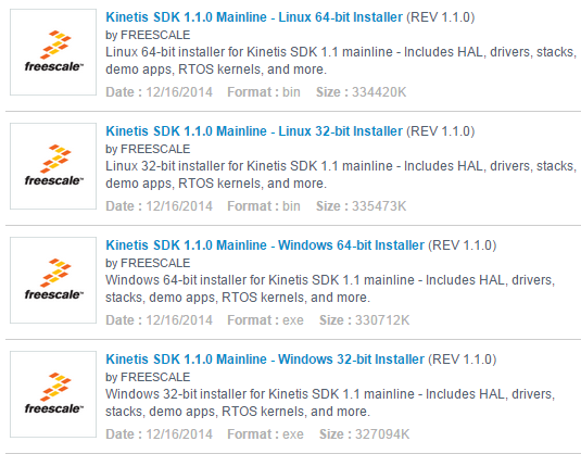

1. Download Kinetis SDK v1.1.0 with MQX RTOS at www.freescale.com/ksdk
Click Download.
Choose the appropriate Kinetis SDK v1.1.0 installer for your operating system, then download and install it.

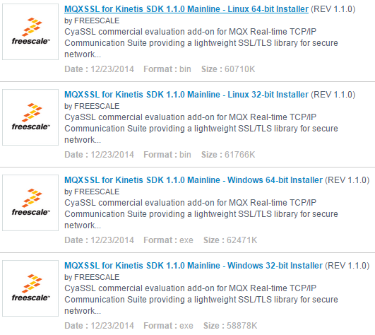

2. Now install CyaSSL for Kinetis SDK v1.1.0 with MQX RTOS
On the left side of the same download page, click Updates and Patches
3. Choose the appropriate CyaSSL installer for your operating system, download and install it.
CyaSSL source files will be installed within the <Kinetis SDK>\tcpip\rtcs\source\ssl\ folder in the Kinetis SDK directory tree.
On Windows, this path is typically: C:\Freescale\KSDK_1.1.0\tcpip\rtcs\source\ssl

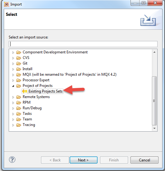

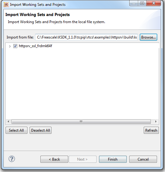

5. First Import the httpsrv_ssl_frdmk64f working set. This includes all the libraries that need to be built.
Browse <Kinetis SDK>\tcpip\rtcs\examples\httpsrv\build\kds\httpsrv_ssl_frdmk64f

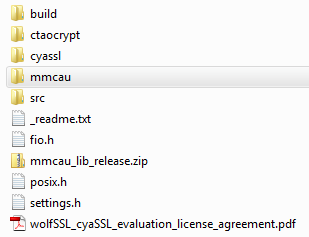

8.       Next download the Freescale MMCAU library to enable hardware acceleration of supported cryptographic functions.
Download the MMCAU software library here.
Unzip mmcau_lib_release.zip and pull out the mmcau folder that is one level under mmcau_lib_release.  Move that folder to <Kinetis SDK>\tcpip\rtcs\source\ssl (or anywhere else if you desire).

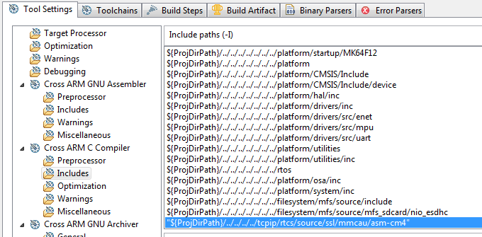

9.       Now add the <Kinetis SDK>\tcpip\rtcs\source\ssl\mmcau\asm-cm4 path to include directory list of the CyaSSL library project.
Right click on the CyaSSL_frdmk64f project and choose Properties
Open C/C++ Build and choose Settings.  Under Cross ARM C CompilerIncludes…add the path  ${ProjDirPath}/../../../../tcpip/rtcs/source/ssl/mmcau/asm-cm4 (or the alternative path you placed the folder).
Click OK to save the setting.

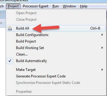

12. Build all the libraries and example project
Select Project…Build ALL
Note: The httpsrv_ssl_frdmk64f project might fail to compile due to the incorrect order of the builds.  If this happens just wait until all the libraries complete their builds, then try to build httpsrv_ssl_frdmk64f again.

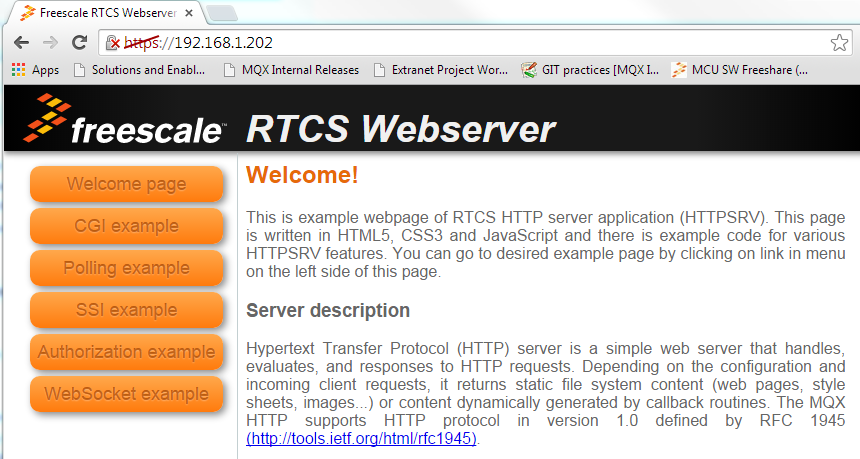

23. Now open a web browser such as Chrome.
24. Type in https://<IPADDRESS_OF_BOARD>  (e.g. https://192.168.1.202

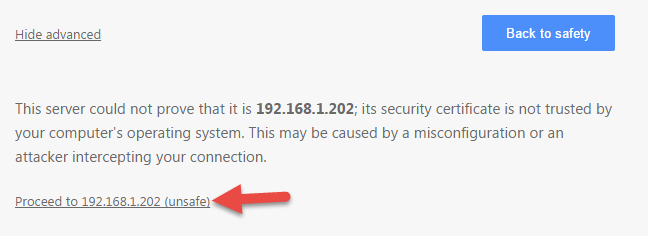

25. Your browser will report that there is a problem with the certificate.  Don’t worry, this is expected!  It is because the certificate used in the demo is self-signed.  Thus, the browser is suspicious of the authenticity, like it should be!
The SSL Certificate and Key are pre-compiled into a Trivial File System (C Array) format and loaded to the Flash memory along with the program code.  These can be used in development, but if you go into production and start shipping your own products, you will need to get a certificate signed by a Certificate Authority (CA) that verifies you are who you say you are.
26. To continue using the self-signed certificate (during development), click Advanced.
27. Then click Proceed to <IP ADDRESS> (unsafe)
28. Now you will have encrypted access to the RTCS webserver demo pages through your browser. (Note: Chrome crosses out the https because of the self-signed certificate used in this example.)
